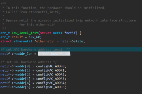

Hi everyone,
I'm new in unsing lwIP.
I'm developing a board using NXP Kinetis K65 device, with FreeRTOS and lwIP, and IAR EWARM compiler/debugger.
I'm testing my application and everything seems woking fine.
Now my problem is how to set a different MAC address for every physical device: I've browsed the source code and it seems that the MAC address is hardcoded in the source file (ethernetif.h).
My idea is to read the MAC address from an otp memory and set it during the initialization phase.
Has anyone some suggestion to solve my problem?
Many thanks
Biafra

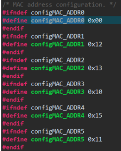

biafra
Senior Contributor I
Hi Gustavo,
I think I've found the solution.
extern unsigned char MACAddress[ 6 ];
#define configMAC_ADDR0 MACAddress[ 0 ]
#define configMAC_ADDR1 MACAddress[ 1 ]
#define configMAC_ADDR2 MACAddress[ 2 ]
#define configMAC_ADDR3 MACAddress[ 3 ]
#define configMAC_ADDR4 MACAddress[ 4 ]
#define configMAC_ADDR5 MACAddress[ 5 ]
memcpy( MACAddress, Mac, sizeof( MACAddress));
Many thanks
Biafra

gustavocosta
Hello bobpaddock,
I believe that what francescobianchini meant was: how to configure the driver with the MAC address I've obtained from a EEPROM (for example) during run-time? Since in lwIP it is hard-coded in the file ethernetif.c and ethernetif.h:
Thank you very much.

xiangjun_rong
Hi, Francesco,
In a local ethernet, the mac address is gotten  from a server generally so that the mac address is guaranteed to not conflict with the other user who use the same local network. This is called DHCP, but it seems that we have not the code for the DHCP, the LWIP stack supports DHCP.
If you want to save mac into OTP memory, as you know that the K66 has IFR in flash module, you can save the mac address in IFR.
Hope it can help you
Xiangjun Rong
