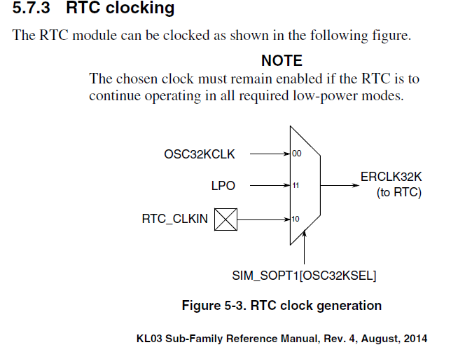

I have a custom board for my project using an MKL03Z32. It does not have an on-board external oscillator. So I want to use the RTC without the external oscillator.
The example project for the FRDM-KL03Z board seems to use the external oscillator. I confirmed this by removing R1 and R3 from the board.
I am running the core clock at 8MHZ. Please let me know how to configure the RTC in this situation.
PS: I was able to get 1 second interrupts from the RTC block by running it with LPO source clock. The problem is however, in this approach, every time you get the interrupt, you have to configure the RTC prescaler to a value (32768-1000) to get the next 1s interrupt. This is not what I desire. In my design, I just want to run the RTC so that the TSR increments every second in RUN mode and in VLLS3 mode and continues to run in the transitions between these modes. The use case is that the RTC is started while in RUN mode, MCU sleeps in VLLS3 mode, wakes up with an external interrupt source to RUN mode, reads the RTC->TSR and stores the value in the flash and sleeps again in VLLS3 mode. I am using the VLPR for other things in my application, so can't use even that.

The FRDM-KL03Z board has integrated the Y1 external crystal with 32.768KHz, I suppose that the example for RTC use external 32.768KHz as clock source.
If you board do not integrate any crystal or clock source, you have to use internal LPO clock as the RTC clock source.
This is the setting of RTC clock source:
so it is okay to set SIM_SOPT1|=3<<18; with the code, the RTC will use LPO as clock source, in the case, you should set the RTC_TPR as 1K, once you set the RTC_TPR when the RTC is disabled, you do not need update the RTC_TPR anymore. You can raed the RTC_TSR register anytime.

gauravbanyal
Hello Xiangjun,
This is exactly what I tried to do expecting the outcome that you have illustrated. But it does not work that way.

xiangjun_rong
Hi, Gaurav,
I think the code is incorrect:RTC->TPR = (32768 - 1000); // use 1kHz internal clock to generate 1s time base by adjusting the prescaler value.
Pls use the code:
void BOARD_SetRtcClockSource(void)
SIM->SOPT1 &= ~SIM_SOPT1_OSC32KSEL_MASK;
SIM->SOPT1 |= SIM_SOPT1_OSC32KSEL(3); // 1kHz LPO
RTC_StopTimer(RTC);
RTC->TPR = 1000; // use 1kHz internal clock to generate 1s time base by adjusting the prescaler value
uint32_t currSeconds = RTC->TSR;
PRINTF("\r\n TIME NOW = %d", rtc_get_seconds());
RTC_StartTimer(RTC);
Because you use 1KHz instead of 32.768KHz, so the RTC->TPR should be 1000 instead of 32768 so that it can genertae 1Hz clock.

gauravbanyal
Hello Xiangjun,
I believe that the value of the pre-scaler that you are proposing is not correct. The pre-scaler seems to be a count-up rather than a count down. From the Reference Manual: "The TSR[TSR] increments when bit 14 of the TPR transitions from a logic one to a logic zero." Bit 14 will transition from 1 to zero (making bit 15 go from zero to 1) when the count on the pre-scaler increments from decimal 32767 to 32768.
When you are using a 32.768kHz clock source for the RTC, the pre-scaler should be zero so that the TSR is incrementer after exactly 32768 clock cycles =>1second
When you are using the LPO clock source, you have a 1kHz clock. So, to get exactly 1 seconds increment on the TSR, you need to set the TPR to (32768-1000) so that it increments to 32768 in exactly 1 second (1000 output clock cycles of LPO).
Hope this clarifies. Please feedback if I have mis-interpreted something from the reference manual.
