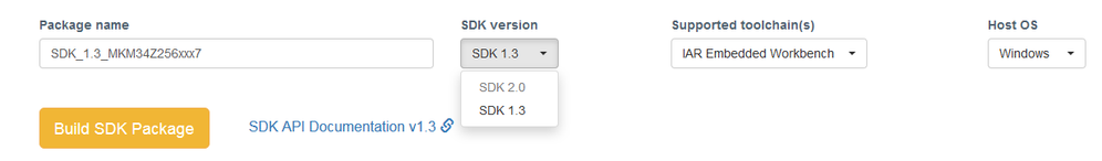

1.  Is the SDK version 2 really ready? I sk since the page allowing it to be configured for a particular configuration and tool set had the SDK 2 option greyed out ??

1. Yes, SDK is ready.
The greyed option means, that for selected MCU is not this KSDK version supported.
For example, in this case I selected MCU KM34Z256xxx7. But at the moment this MCU is supported only in SDK 1.3, not in SDK 2.0.

In the KDS File-New menu I have 2 menu items for a SDK2.x Project and one for a SDK1.x Project.  Using the SDK1.x option the 3rd screen titled has all the SDK options greyed out. I now suspect that this is because my processor, a KL25Z25Z128VLK is not supported by the SDK.  If that is the case, then tat is that, end of story.  o you know if there is another suitable IDE that is for use on Linux?  Also is there anything to support a KL25...  chip in the way of HAL etc?

MKL25Z128xxx4 should be supported in KSDK 2.0 Release 2, which we expect in these 14 days.
please see Introducing Kinetis SDK v2
So, you will be able to use KSDK and KDS for your MCU.

MKL25Z128xxx4 is supported now.
Please check it and let me know.
