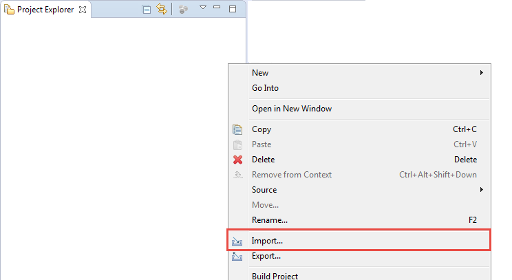

1. Open KDS, go to Project Explorer Window and by right click select Import option

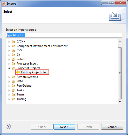

2. Choose Existing Projects Sets option

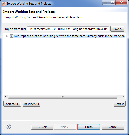

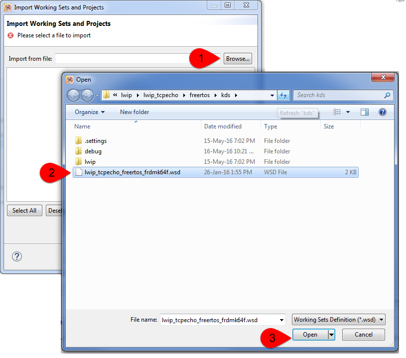

3. Click on Browse and select the project, which you would like to work.
In case of KSDK 2.0 go to
C:\Freescale\<ksdk2.0_package>\boards\frdmk64f\demo_apps\lwip\lwip_tcpecho\freertos\kds

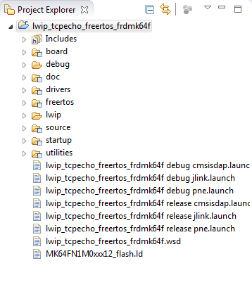

4. You will see the demo project successfully imported in your Project Explorer window
and now you can compile and execute demo project.
