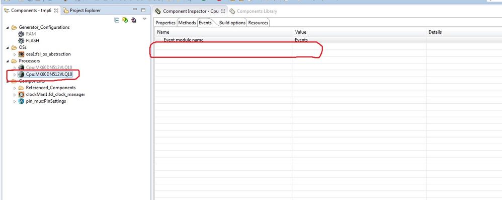

Hello.
i used codeWirrior and now i transfer to KDS.
I want to apply interruption of OnLowVoltageINT.
OnLowVoltageINT is called when Low Voltage interrupt had occured.
How to generate this interrupt in KSDK?

Hello Prof,
You can still use the Processor Expert without KSDK, it have this interrupt .
When you create project only select PE:
Then you can see :
Hope it helps
Alice

Hello, Alice.
I generated the project as you showed.
that not so with my project

Hello Prof,
I have not in the KSDK+PE project , there isn't this selection .
In the PE project without KSDK, there is , about the PE project , when you
create project , please select the "Processor Expert", do not select "kinetis SDK"
