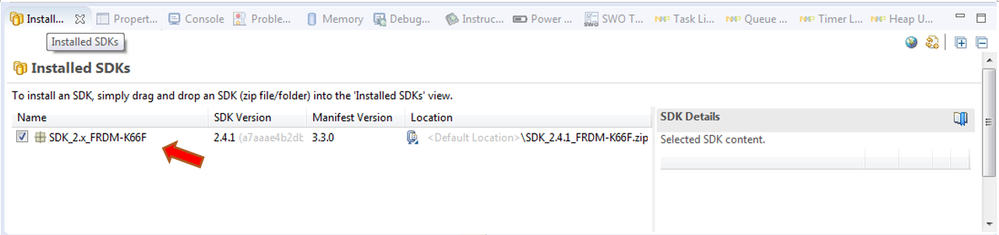

Download the SDK package SDK_2.4.1_FRDM-K66F.zip,  drag and drop it into the “Installed SDKs” view. You will be prompted with a dialog asking you to confirm the import –click OK. The SDK will be automatically installed into MCUXpresso IDE part support repository.

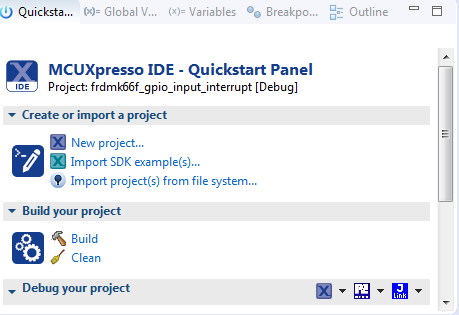

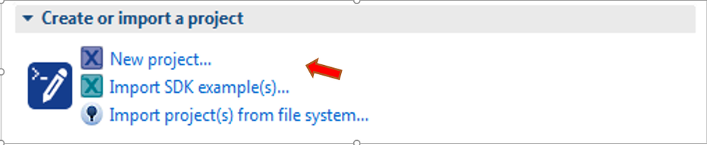

Go to the ‘QuickStart’ Panel in the bottom left of the MCUXpresso IDE window, and click new project.

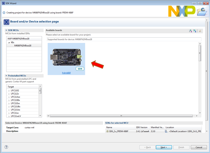

On the “Board and/or device selection” page, select board frdmk66f. You will see some description relating to the your selection.
Click ‘next’…

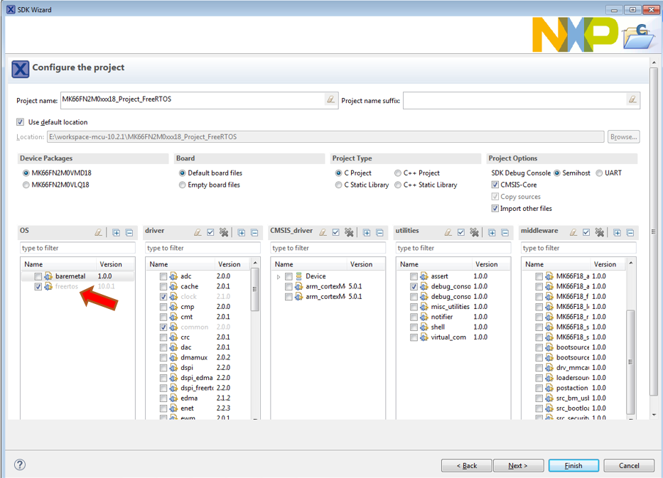

You will see the basic project creation and setting page.
Basic setting
The project will be given a default name based on the MCU name. Name the project, select the right device package.
Board files: This field allows the automatic selection of a default set of board support files, else empty board files will be created.
Project type:  Selecting ‘C’ will automatically select Redlib libraries, selecting c++ will select NewllibNaro librarires.
Project option: enable semihost will cause the semihost variant of the chosen library to be selected;  CMSIS-Core will cause a CMSIS folder containing a variety of support code to be created.
OS: For a FreeRTOS project, make sure FreeRTOS is selected.
Please select the drivers and utilities according to your requirements.

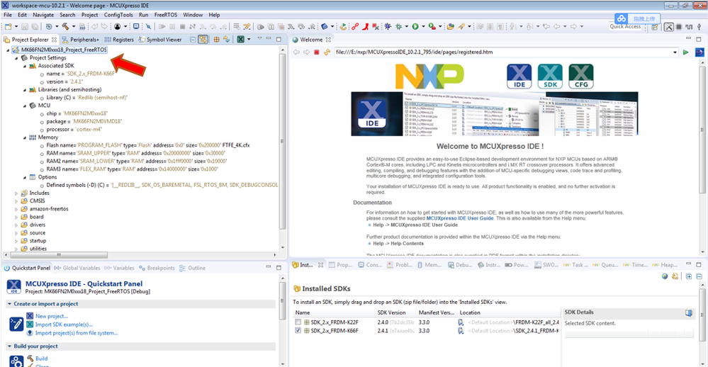

Click the project settings, we can see some basic information of this project, a right click on these nodes provides direct options to edit the associated setting.

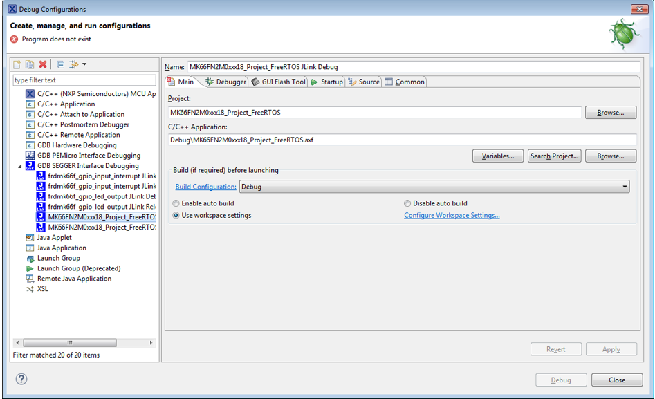

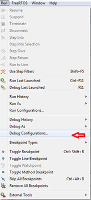

Go to menu Run> Debug configurations…
Select the ‘Debug configuration’ that matches your connection type, in this example Segger Jlink is used. Then click ‘Apply’ and ‘Debug’

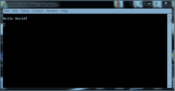

Open a terminal, select the appropriate port and set baudrate to 115200
Run the application, you will see “Hello world” in terminal

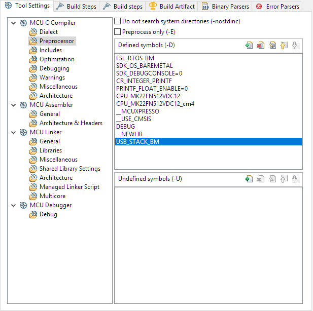

MCUXpresso is really giving me a headache. If I create a new FreeRTOS project for my board (IMX1050 RT), trying to compile the empty project gives me this error:
In file included from ../usb/include/usb.h:15:0,
                 from ../usb/host/usb_host.h:12,
                 from ../usb/host/usb_host_framework.c:10:
../osa/usb_osa.h:77:10: fatal error: usb_osa_bm.h: No such file or directory
I traced it down to this ifdef in usb_osa.h:
/* Include required header file based on RTOS selection */
#if defined(USB_STACK_BM)
#include "usb_osa_bm.h"
#elif defined(USB_STACK_FREERTOS)
#include "usb_osa_freertos.h"
But where is USB_STACK_FREERTOS defined? Looking at an RTOS usb example, I discovered it in the XML .cproject file. However, a new RTOS project doesn't correctly include these preprocessor definitions.
In this case, I can find and fix the solution, but chasing down these bugs in the IDE is exhausting. Just a heads up..
The SDK examples are defining these defines in the compiler settings, e.g.
I hope this helps,
Erich
