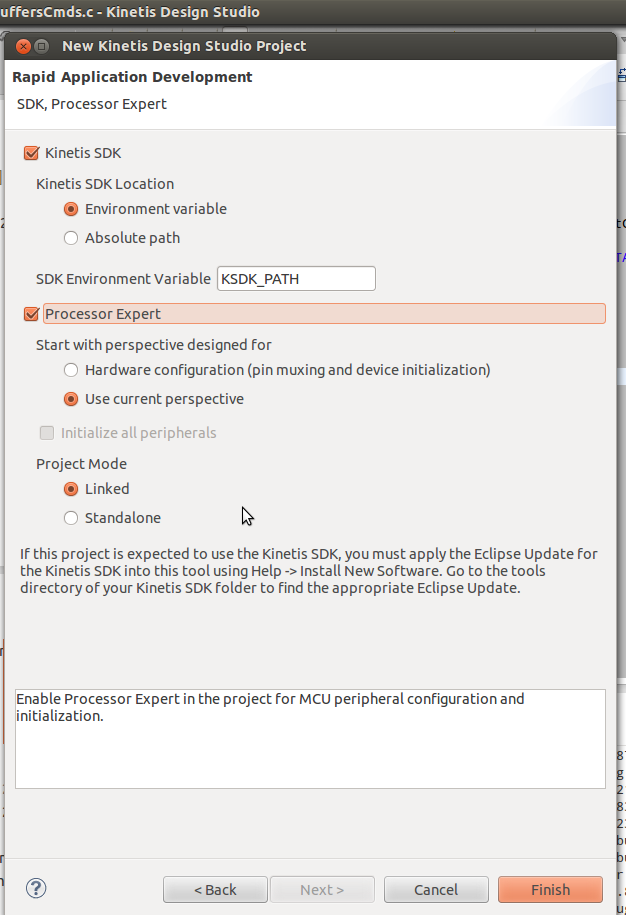

I created  a project using New->Kinetis Design Studio Project... and I checked the options to use "Kinetis SDK" and "Processor Expert"Capture du 2015-01-21 08_37_35.png.
I use MQX.
To "import" the project to KDS 2.0.0 I don't did anything. I installed KDS 2.0.0 and I have reopen it and the project worked fine.
