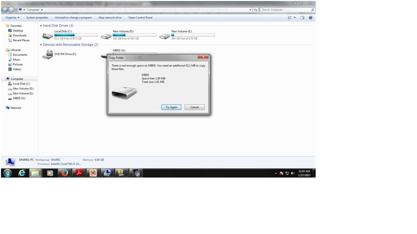

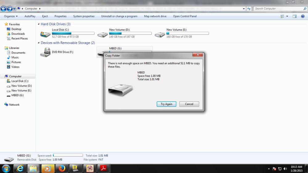

3,148 Views
sudhakarp
Contributor V
am looking *.elf file. if file size more than 1mb means i cant dump that project through openSDA (mbed). how to debug that project throught KDS IDE

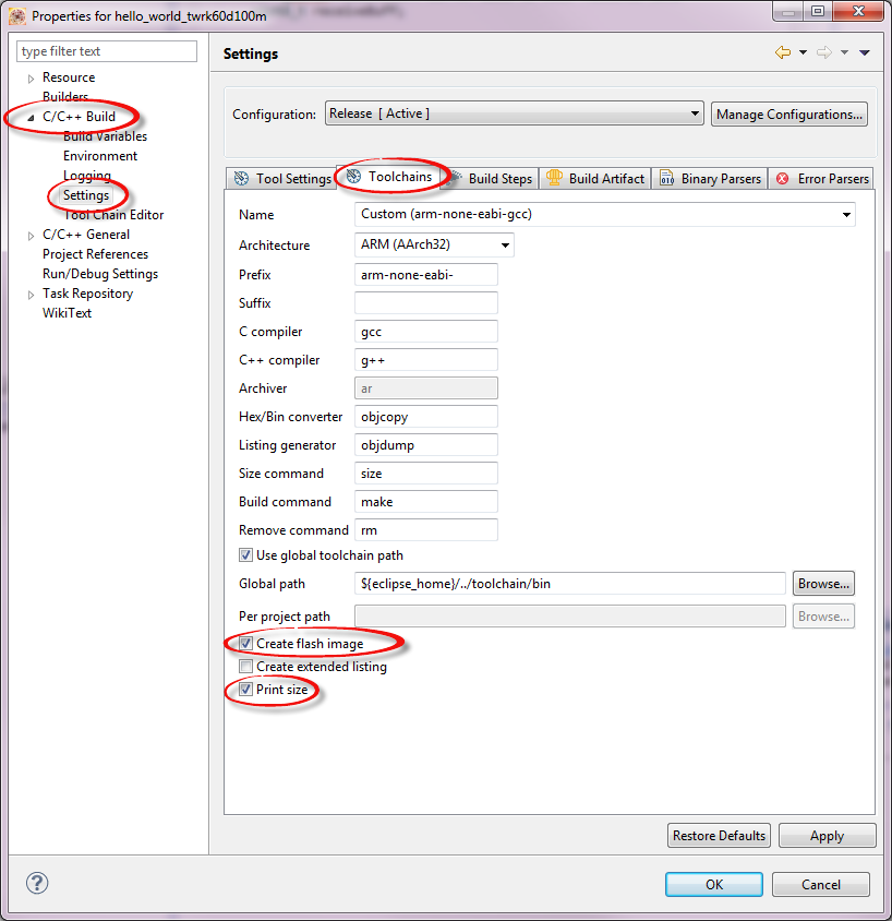

ivadorazinova
Hello sudhakar p,
in KDS : please, right click on the project > Properties > C/C++ Build > Settings and set Create flash image and Print size.
After that, srec file is created (in Debug folder) - the file you can copy though the OpenSDA.
I hope it helps.
