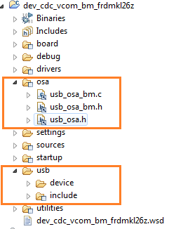

jorge_a_vazquez
Hi Giuliano Vitor
You need to include the middleware in your project configuration, you could use the example code as reference, I will use the kl26z to show how to do it. Next image show the structure and the needed files for usb cdc vcom example:
Some of them can be found in the middleware and others are more app specific so are located in the example path.
In the example project properties->C/C++ Build->Settings->C Compiler-> includes you can see the needed paths for the usb example are:
these "../../../" are relative paths for the location of the example project, but in your case you can use something like {your_path_SDK_2.0_FRDM-KL26Z}\middleware\usb_1.1.0
