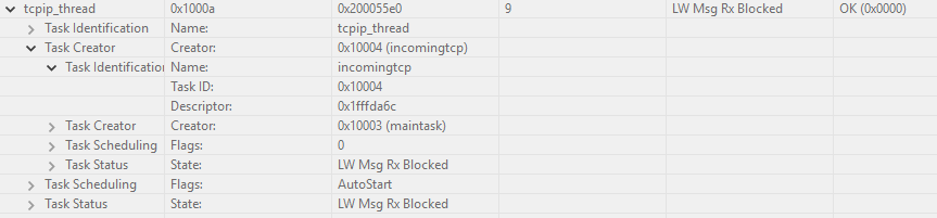

When I remove the ethenet cable, the loop never exits like I would expect.  Outside the loop is where I call netconn_close and netconn_delete.  Because the loop doesn't exit, I cannot reconnect to my device after plugging the cable back in.
I can't get any MQX task data when I pause execution, but at one time I did see that the lwIP tcpip_task was blocked on a semaphore.
Can anyone suggest ways that I should be handling cable disconnections in lwIP?

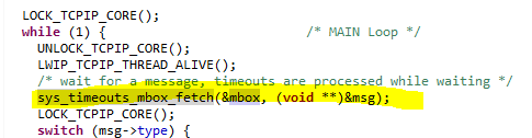

Actually, even if I am able to detect the problem, I'm not sure yet what to do with it.  The main issue is really that the lwip tcpip_thread remains blocked if I pull the Ethernet cable.  This prevents me from reconnecting to my device.
In tcpip_thread, this looks like the only place it could be held up:
Here's what I have found -- when the cable is disconnected, sys_arch_mbox_fetch returns SYS_ARCH_TIMEOUT, which calls a handler and then jumps to a label called "again".  This is what is causing the tcpip_thread to look like it's blocked on a semaphore in the TAD view -- because the cable is disconnected, there isn't any data to get from the mbox, and the code just loops back and tries again.
I have a massive hack that seems to get things going in the right direction.  I replaced the "goto again" in sys_timeouts_mbox_fetch to this:
      if( attempts++ < 10)
       goto again;
      else
       return;
What this does is allow the function to return after the timeout functions (tcpip, arp, dhcp, etc) timeout a certain number of times.  It's clunky, but seems to work.  The return statement will result in the caller detecting an invalid message, which is logged and ignored, which I think will work for me.  One issue with this solution that bothers me is the 10 attempts.  I selected that because there are cases where we do need retry pulling data from the mbox even when the cable is connected.  So 10 is basically just the threshold where I seem to have reliable network communications, but can also recognize a disconnected cable and recover in a timely manner when the cable is eventually reconnected.
However, there must be a better way to deal with disconnections than this.  I'll keep working on a better solution, but if you have any ideas, please let me know!  Thanks, DavidS​
