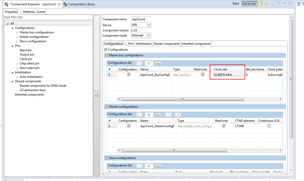

I am making progress with my Kinetis/KSDK 1.3/PE 3.0.2 SD Card software for SPI on a FRDM-K22F Board (going to a custom K22 board in the future).
One question, how do I increase the SPI speed after I set it originally using the DSPI_DRV_MasterConfigureBus (I'm using Interrupt based SPI right now) to 375kbps?  After the card is initialized, I should be able to run it at a faster data rate.
I want to run at at least 10 MHz.
I'm using a K22F and when I look at the SPI clocking options in PE, I see that the maximum (using the default Clock cfg.4) is 2.4 MHz although that's "From" and "To" says 12 MHz.  Can anybody explain this?

Hello myke,
I check on my side , the  clock rate of spi can configured to 10MHZ, and could you please show your project , and how about your
bus clock of mcu, the clock source of SPI is the bus clock .
And i recommend you do not change the speed when run the project , it maybe cause unpredictable problems .

Hi Alice,
Thank you for the reply - to change the speed in the application, I found that re-running "DSPI_DRV_MasterConfigureBus" when I wanted to change the speed worked for me.
By doing this on a FRDM-K22F, I found that the maximum speed that I seemed to be able to change the stock hardware to is 4.8 Mbps.  I haven't pushed it to 10 Mbps or looked at changing the internal clocking information.

Hi Alice,
Yes it has, I am calling the DSPI_DRV_MasterConfigureBus API to change the speed before initializing the SD Card and then increase the speed after initializing the card.
