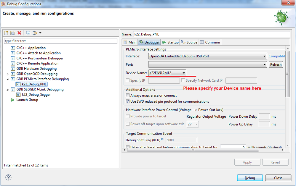

Rick_Li
Hi Kenneth,
Could you please try the below steps:
1) in KDS IDE, right click your project and then "Debug As"->"Debug Configuration..."
2) select your device name and then debug, see below image (it was a project for k22, so, please specify your target devicce):
hope it helps!
2,302 Views
kennethgraakjær
That was what I was trying to explain in point 2 above.
When I do that (and select the board as kl43z256m4 (from memory, it may be slightly different) it gives me the following error:
PE-ERROR: Unable to auto-detect debug hardware. Please specify on the command-line. Halting.
I tried from a base install of kds and I tried to install the linux drivers from the PEMicro homepage. Same result in both cases.
