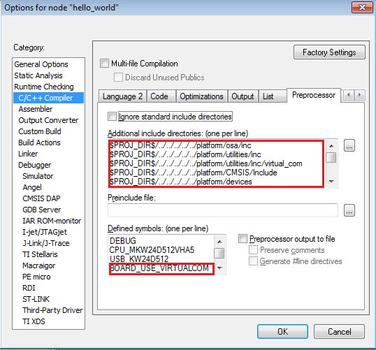

macl
Senior Contributor I
Try the steps from this example:
For example on FRDM-K27,  the steps to make USB virtual com work:
  • - Build USB lib from folder Freescale\KSDK_1.2.0\usb\usb_core\device\build\iar\usbd_sdk_frdmkl27z_bm\usbd_sdk_frdmkl27z_bm.eww . If you use other rtos, you must build corresponding lib.
  • - Add file  virtual_com.c, virtual_com.h , usb_descriptor.c, usb_descriptor.c.h from Freescale\KSDK_1.2.0\platform\utilities\src virtual com to project
  • - In project option  C/C++ Complier -> Preprocessor include path
$PROJ_DIR$/../../../../../platform/osa/inc
$PROJ_DIR$/../../../../../platform/utilities/inc
$PROJ_DIR$/../../../../../platform/CMSIS/Include
$PROJ_DIR$/../../../../../platform/devices
$PROJ_DIR$/../../../../../platform/devices/MKL27Z644/include
$PROJ_DIR$/../../../../../platform/devices/MKL27Z644/startup
$PROJ_DIR$/../../../../../platform/hal/inc
$PROJ_DIR$/../../../../../platform/drivers/inc
$PROJ_DIR$/../../../../../platform/system/inc
$PROJ_DIR$/../../..
$PROJ_DIR$/../../../../../platform/utilities/inc/virtual_com
$PROJ_DIR$/../../../../../usb/usb_core/device/include/frdmkl27z
$PROJ_DIR$/../../../../../usb/usb_core/include
$PROJ_DIR$/../../../../../usb/adapter/sources
$PROJ_DIR$/../../../../../usb/adapter/sources/sdk
$PROJ_DIR$/../../../../../usb/usb_core/hal
$PROJ_DIR$/../../../../../usb/usb_core/device/sources/classes/audio
$PROJ_DIR$/../../../../../usb/usb_core/device/sources/classes/cdc
$PROJ_DIR$/../../../../../usb/usb_core/device/sources/classes/common
$PROJ_DIR$/../../../../../usb/usb_core/device/sources/classes/composite
$PROJ_DIR$/../../../../../usb/usb_core/device/sources/classes/hid
$PROJ_DIR$/../../../../../usb/usb_core/device/sources/classes/include
$PROJ_DIR$/../../../../../usb/usb_core/device/sources/classes/msd
$PROJ_DIR$/../../../../../usb/usb_core/device/sources/classes/phdc
$PROJ_DIR$/../../../../../usb/usb_core/device/sources/controller/khci
  • - Add BOARD_USE_VIRTUALCOM definition in project setting

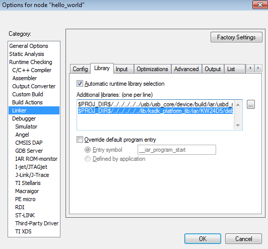

  • - In linker option, add lib usb to project $PROJ_DIR$/../../../../../lib/ksdk_platform_lib/iar/KL27Z644/debug/libksdk_platform.a
With release target, you must include release usb lib.a

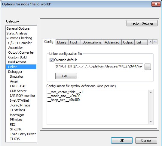

  • - In linker/config
__ram_vector_table__=1
__stack_size__=0x400
__heap_size__=0x400
