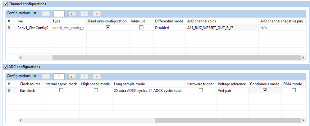

I am trying to set up the K24 for single, software triggered ADC sampling.  I have looked through the ADC example in the SDK for this board, as well as a couple other user examples, and tried to adapt them as best I could to what I want to do.  Below is some modified code from the ADC example.

Here is the config screen for the PE fsl_adc16 module:

Regarding your question that the K24 stuck in the default ISR because of unknown reason. After the K24 enters default ISR, pls check the low 9 bits in XPSR register to know the interrupt source vector so that you can know the interrupt source. Most of time, I suppose it is 3, which means hard fault.
Regarding your code, if you use "C plus Assembly" programming, you should read the calling convention of the compiler you are using, and comply to the regulation, for example you should understand which register you can use, which register should be saved in callee function, how the parameters are transferred. For example, in the read2() function, you do not push/pop r2 and r3, it may leads to issue.
I suggest you use C language programming so that the C compiler can do all the work.

Hi, Devin,
It is difficult to track the error  without source code, I suggest you attach all the project so that we can test your code based on our board.
