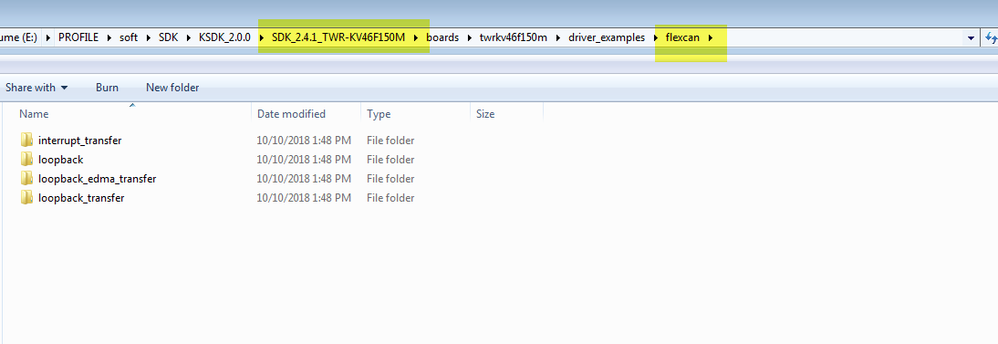

I try to communicate between TWR-KV46F150M and another board that can communicate with CAN bus.
But I can't find CAN communication example in SDK_2.4.1_TWR-KV46F150M.
Is not the CAN bus present in the TWR-KV46F150M for communication between other MCUs?
1,635 Views
kerryzhou
Hi Inseob Kim,
   SDK_2.4.1_TWR-KV46F150M already have the CAN driver, please check flexcan folder:
SDK_2.4.1_TWR-KV46F150M\boards\twrkv46f150m\driver_examples\flexcan
  This is the CAN project from my side:
Wish it helps you!
If you still have questions about it, please kindly let me know.
Kerry
