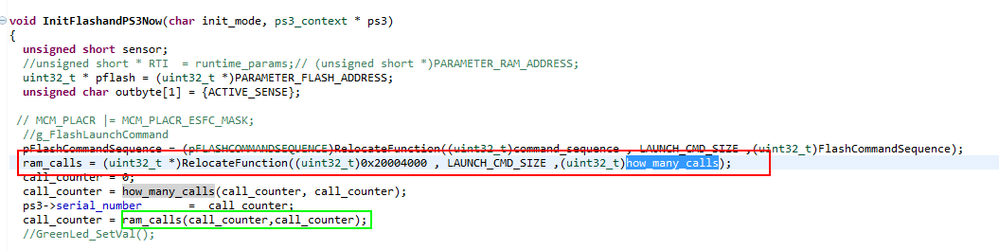

I am using the fsl_flash Peripheral Driver from SDK 1.2.0 on KDS 3.0.  Because this part does not have flex Ram
it only has 1 bank of flash.. Therefore when writing to the flash code must make a detour to RAM. The Driver
provides "RelocateFunction()" to move code to RAM. This works, although it does seem to have a bug (more on that later).
My problem is that the code jumps to the Ram Based function, the chip hangs up immediately.
#define LAUNCH_CMD_SIZE  0x100;
uint8_t command_sequence[LAUNCH_CMD_SIZE];
pFLASHCOMMANDSEQUENCE pFlashCommandSequence;
  uint32_t  pflash   = 0x00038400;
  pFlashCommandSequence = (pFLASHCOMMANDSEQUENCE)RelocateFunction((uint32_t)command_sequence , LAUNCH_CMD_SIZE ,(uint32_t)FlashCommandSequence);
  FlashEraseSector(&flash1_InitConfig0, pflash, FSL_FEATURE_FLASH_PFLASH_BLOCK_SECTOR_SIZE, pFlashCommandSequence);
At the bottom of FlashEraseSector:
        ret = pFlashCommandSequence(pSSDConfig);
This is where it crashes.
I have tried writing very simple functions to execute in RAM. I cant get that to work.
I tried using the demo aps: Flash_demo_twrk22f120m it worked once and then stopped.
There must be a compiler, linker or debugger setting causing my problem.

Hello Dave,
1) Check the memory to be sure the copy to ram succeed.
2) Please change the erase address 0x38400 to 0x3800 to have a  try .
If still can not work , you can sen your project to me , i will debug it on my side to check the problem.
Hope it helps
Alice

1) Copy to RAM was successful. Although I did need to modify RelocateFunction() to make it work.
2)I used the Address 0x38400 is a typo.. Actually the code uses 0x3f800 which is on the correct border.
Where and how do i send you my project?

Hello DAVID,
I have received your project from email.
- In the project , relocate the fucntion "how_many_calls" to 0x20004000,  i only changed one place, then it can work well.
i changed
   call_counter = ram_calls(call_counter);         to
  call_counter = ram_calls(call_counter,call_counter);
then i build and debug , this funciton can work well , please see the screenshot when i debug , pay attention the variable of " call_counter" .pastedImage_1.png
- In the project you send to me , i have not fund the use the function about "FlashCommandSequence" after you relocate it .
Hope it helps
Alice

davestarkey
While you certainly found an error in my code. When i fixed it my problem remains.
I have cleaned up the code now. So there is no confusion between the flash code and just
executing out of RAM which is the real problem.
Here is a the code now. I will attach a zip of the project.  I am pretty sure the problem
is in my setting up KDS rather than actually the code itself.
#if TEST_RAM_EXECUTION
uint32_t how_many_calls(uint32_t calls,uint32_t incr);
  calls++;
  calls += incr;
  return calls;
void test_ram_execution(ps3_context * ps3)
  uint32_t (* ram_calls)(uint32_t,uint32_t);
  uint32_t call_counter;
  ram_calls = RelocateFunction((uint32_t)0x20004000 , LAUNCH_CMD_SIZE ,(uint32_t)how_many_calls);
  call_counter = ps3->serial_number;
  call_counter = how_many_calls(call_counter, call_counter);
  ps3->serial_number       =  call_counter;
  INT_SYS_DisableIRQGlobal();
  call_counter = ram_calls(call_counter, call_counter);
  INT_SYS_EnableIRQGlobal();
#endif
