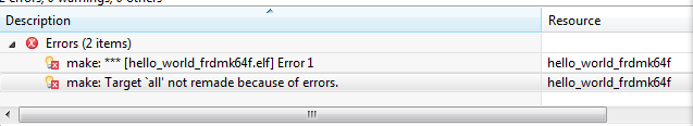

Hi all!!
I am a beginner of FRDM-K64. I followed all the procedure from Freedom Development Platform for Kinetis K|Freescale    But When I was in "begin and run" section and tried to build the hello world project demo I was told 103039_103039.pngpastedImage_1.png
Please help me out and I will really appreciate it.!!1
thanks!!

Hi Lee,
the error message mentioned above means, that you have a problem with .elf file (i.g. is not created),
if you import demo code, .wsd file it is always needed to build library first and then the project.
After that, correctly set debugger.
Please, have you followed all mentioned steps?

Hi Simon,
it looks you have not compiled libraries.
I recommend you Getting Started with KSDK 1.3​
Please, have you tried import .wsd file? I described it here
i can import ,sample codes of ksdk for mk22f in kds3.0,it shows Program "make" not found in PATH er...
Let me know, if it helps you.
Iva

Did you watch the video in section 3 Build, Run and went through the steps?
(i.e. updating Eclipse, building platform library)

Ok, there is a trap in the documentation.
The step "Build, Download and Run" is not well explained.
You have to use a different firmware for your board, i.e. Segger J-Link or PE-Micro.
The default firmware will not work.
Try the combination Segger J-Link (it's free) and KDS.
In this case you have to download the bootloader on your board first.
Take a look at:
https://community.freescale.com/docs/DOC-105199
and
http://cache.freescale.com/files/soft_dev_tools/doc/support_info/KSDK13GSUG.pdf?fsrch=1&sr=8&pageNum...
Skip the sections IAR, Keil, TrueStudio and ARM GCC.
When you've updated the firmware on the board,
you'll use the Debug, not Run. It will also flash.
Described on page 29 of the doc in the 2nd link.
