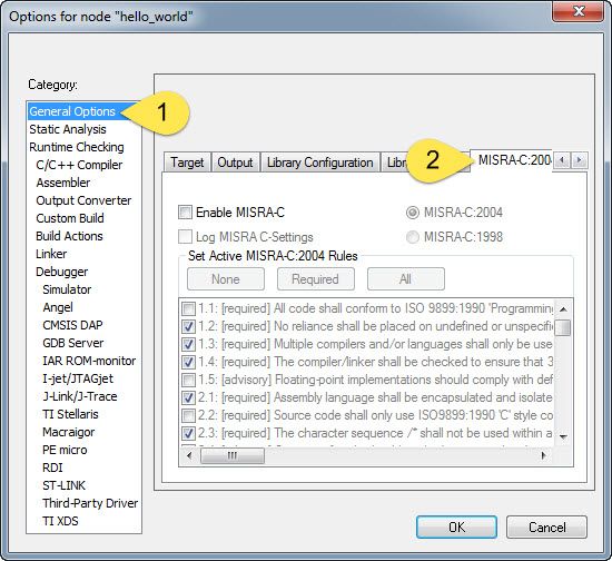

With a KSDK project or workspace open in IAR, use the IAR menu Project->Options.  Use the screenshot below to find the MISRA-C:2004 settings.

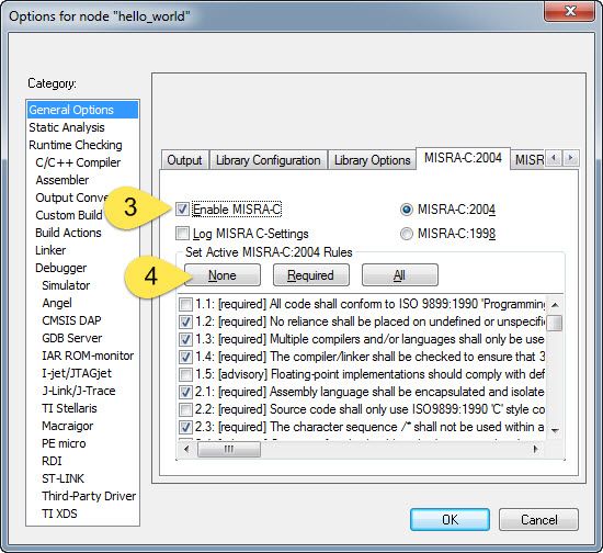

To disable the MISRA checking, first check the box to Enable MISRA-C.  Then clock the None button

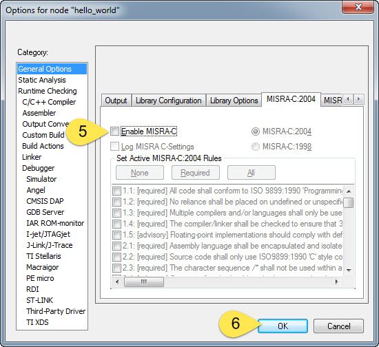

Once the MISRA rules are unselected, uncheck the box Enable MISRA-C.  Then click the OK button to save these changes to the project.  Now the project will be built without the MISRA checks.  Remember to do this for every KSDK library and example project before building.
