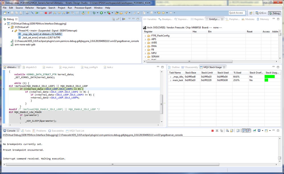

I am working on a custom board equipped with K66 MCU, three quadrature decoders and other peripherals. Since three quadrature decoders, I am going to utilized FTM1, and 2 for two devices, and general gpio interrupt for the other. The software development is based on KDS3.0 and KSDK1.2. The first thing I would like to do is verifying the integrity of GPIO interrupt from encoder. I basically jump the FTM1_QD_PHA and FTM1_QD_PHB signals to PTE8, and PTE9, and a motor encoder signal connects to FTM1. Therefore, the same encoder signal should feed to both FTM1 and GPIO port E. When I test it with bare board and SDK platform only, the had pretty match count from both decoder. This gives me confirmation that FTM and GPIO interrupt and decoder algorithm are running OK. However, if I have similar code and utilize SDK with MQX, I am facing lose count on GPIO interrupt. For example I ran the motor about 3 seconds (the encoder signals tick in at 6.64kHz, 150us period), the FTM reads 61438 count, but GPIO interrupt counts 60967.  I am wondering if I miss something, or this is drawback of utilizing MQX. Does MQX take lots of CPU resource that cause losing interrupt? If you have any idea or recommendation please let me know. Thank you very much.

Since you mentioned about priority. I have tried declear GPIO interrupt priority NVIC_SetPriority(PORTE_IRQn, 2U); in the encoderZ_Init(). I see match reading in a very short time, after a while the software stopped. If I set priority to 4. it doesn't help! But the software continue run without problem. As my understanding, priority 2 is the highest priority in the MQX default. Let me know if any other though. Thanks!

" Due to the MQX RTOS interrupt handling mechanism, the names of the ISR entry functions must be different than those in the CMSIS startup code file (startup_<device>.S), otherwise the kernel ISR is not called when the corresponding interrupt triggers. "
These  words is from the DOC of my colleague Jorge Gonzalez  :
Interrupt handling with KSDK and Kinetis Design Studio
I think you can check this , maybe it can help you .
