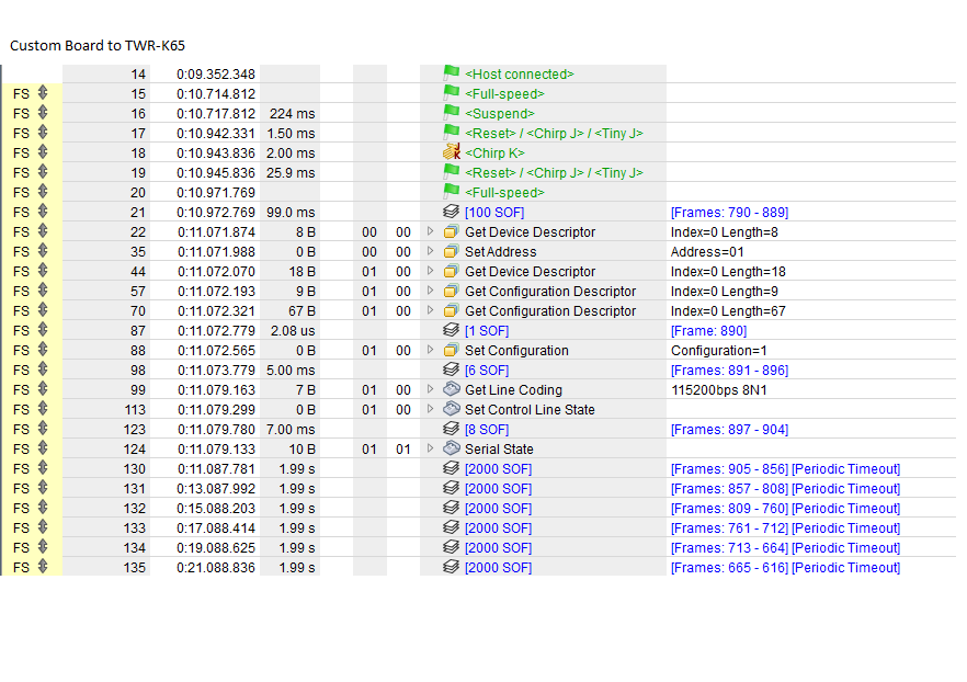

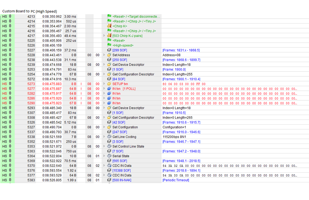

I have a TWR-K65F180M as a full speed cdc host (using USB0 - KHCI) and a custom board (using USB1 - EHCI) as a high speed CDC device. My custom board enumerates fine with Windows and sends serial traffic just fine as well (high speed mode). When I plug it into my TWR-K65F180M, I can see on my analyzer that it negotiates to full speed and enumerates correctly (all the control descriptors seem to be exchanged just fine), but none of my IN packets are getting sent to the host, though I do see the periodic SOF packets.
Comparing the trace of descriptors, the only differences are related to full speed vs high speed (frame sizes, etc).
I am using the SDK_2.0 usb_cdc_host example code (with KHCI). If I switch to use the usb_host_hid_mouse example and plug in a mouse, it works great, so I think that electrically, everything is good.
Aside from setting the KHCI flag on the host (and EHCI flag on the device), is there something else I need for this to work?

That is true and if I use those examples, it works as expected for loopback, but I should be able to modify that so that I can just send IN packets (as shown in this post KSDK VCOM example does not work without loopback​ ).
I have made the modifications, and can still not get IN packets to go out on their own. As I stated, if I use a Windows host, I can get only IN packets to send. What would be the difference between the Windows host and the TWR host. Does the TWR host also require loopback to work properly?

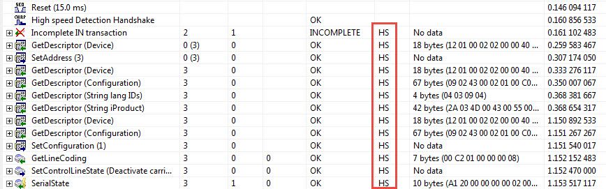

First of all, I tested TWR-K65F180M board on PC and it is enumerated as HS device:
Then, I connected this same device to FRDM-K64F which only supports FS and it was working well:
Have you tried by using another FS Host?
Isaac

My trace to the PC looks a lot like yours (attached both). The strange thing is that it enumerates fine in both cases. It is just the IN packets that I don't see. I will try sending OUT packets too to see what happens.
7,116 Views
brycelembke
I started sending OUT packets and THEN I started to get IN packets (but only each time I send an OUT - see attached image). I would think the IN packets should come in regardless of whether there is OUT traffic (it does in my Windows USB host trace).
