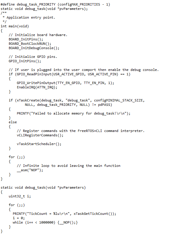

I'm using FreeRTOS with SDK_2.0_MK24FN1M0xxx12 on a custom board. And I'm using the default clock configuration created with the new clock tool in KEx Tools v2.0 (FEI MCG Mode, System clock 20.97152 MHz). Also I'm using the default FreeRTOSConfig.h. I wrote a simple task to periodically print the tick count but xTaskIncrementTick() in task.c never gets called and the tick count remains 0. Any ideas on what the problem is? I'm assuming the SysTick interrupt is enabled by default (bad assumption?).
Thank you,
Peter

Hi Peter,
Your event.c had SysTick_Handler() implemented and this was trumping the port.c SysTick_Handler() function causing the tick not to occur properly.
In event.c I did following:
#if 0         //DES 0=test, 1=default code
void SysTick_Handler(void)
    g_timeMilliseconds++;
#endif
Re-compile and ran and hit breakpoint inside the port.c void xPortSysTickHandler(void) handler.
BTW: when your event.c SysTick_Handler() used, it is working but other  RTOS scheduler stuff needs xTickCount to be incrementing to allow RTOS to function correctly (I think).

peterfurey
Thank you very much David! That event.c module is something that I imported from the sdcard_fatfs_frdmk64f example project when I was trying to get my sdcard/filesystem interface working but I notice now that that project wasn't using FreeRTOS so there was no conflict. I very much appreciate you taking the time to track that down for me, I was stumped.
