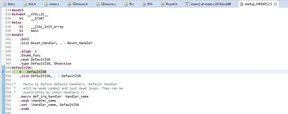

neilporven
Senior Contributor I
Ok,
another hint after digging around a bit more:
It seems that it comes from Reset_Handler......
Not sure what or how this is happening???

BlackNight
The Outline only shows you the first match.
I still think you are running into a hard fault. Unless do you have a HardFault_Handler defined in your system (do you?).
Keep in mind that the default handlers are 'weak' (see line 356).
Bottom line: add that hardfault handler as outlined in my article so you know what is happening.
I hope this helps,
Erich

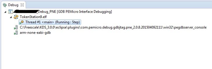

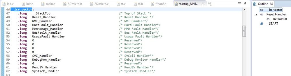

neilporven
Hi Erich,
I don't believe it is, I am pasting what the debugger is showing:
Notice that its not showing the ISR.
I have a picture of the actual spot:
I am not sure if I'm declaring this correct or using it correctly:
//Get current working directory
fr = f_getcwd (filename,sizeof(filename));
