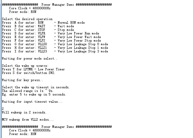

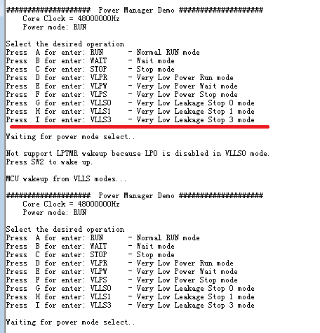

There is a power manager demo in KSDK installation folder, which can wake up from VLSS3 by LPTMR.
SDK_2.2_FRDM-KL03Z\boards\frdmkl03z\demo_apps\power_manager
Please see the below picture, I select  'I' to enter VLLS3, next I input 'T' to select LPTMR as wake up source (I enabled LPO)

danielchen
Hi Gaurav Banyal
