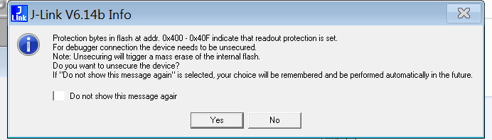

So I'm trying with a Segger Jlink.  I cut J8 and J12 to isolate the KV10Z and here's where I am so far.
1) You'll see a reset attempt fail with just the SWD_DIO/CLK attached
2) You'll see that even pulling reset low for the KV10Z does not seem to help the situation
Initial SWD Unlock Failure
Device "MKV10Z32XXX7" selected.
Found SWD-DP with ID 0x0BC11477
Protection bytes in flash at addr. 0x400 - 0x40F indicate that readout protection is set.
For debugger connection the device needs to be unsecured.
Note: Unsecuring will trigger a mass erase of the internal flash.
Device will be unsecured now.
****** Error: Kinetis (connect): Timeout while unsecuring device. Erase never starts.
Kinetis (connect): Failed to unsecure Kinetis device.
Cannot connect to target.
Pull RST_TGTMCU_B Low
J-Link>

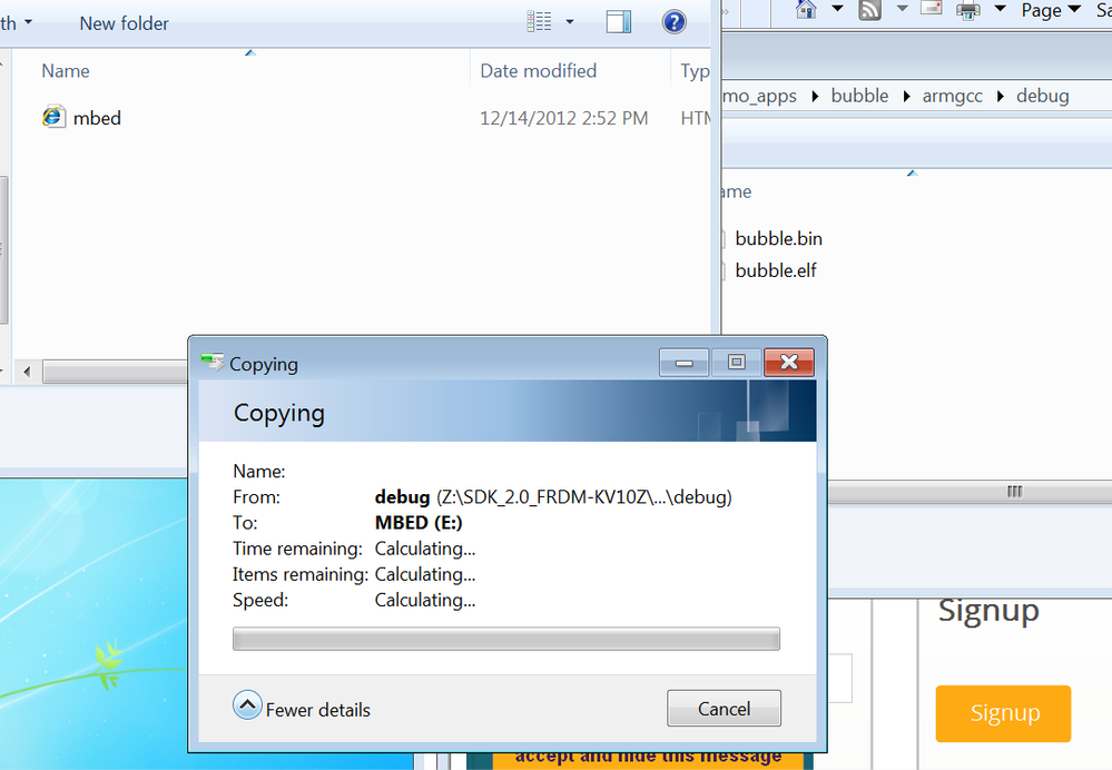

eljeffo
Just to verify it wasn't a mac problem I tried uploading a .bin file via Windows 7.  Same issue, board completely stalls:
