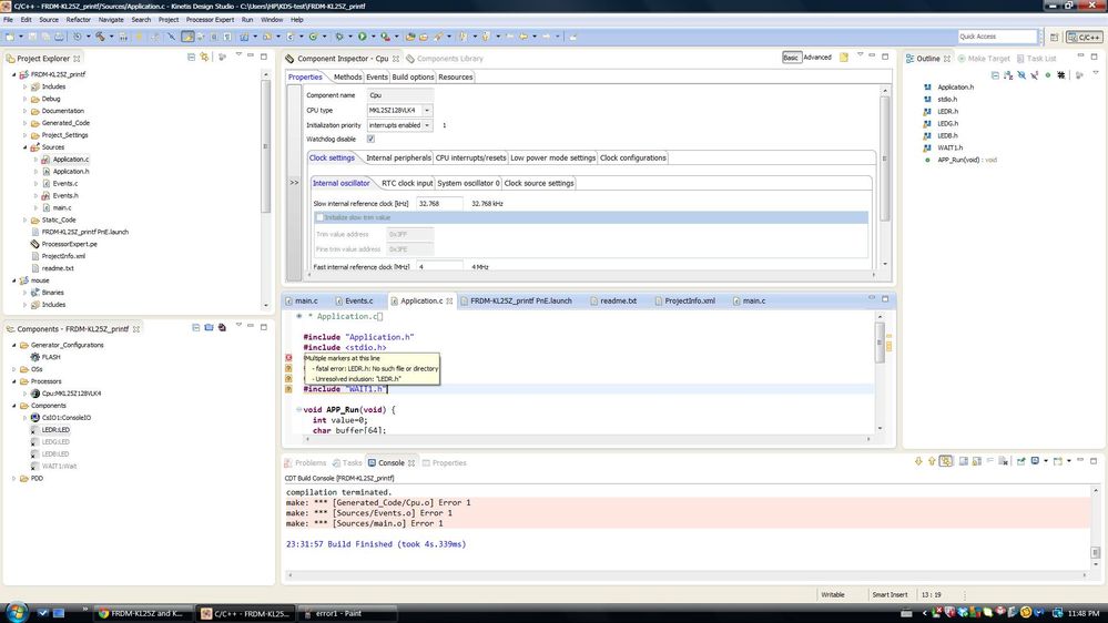

I just started using Freescale KL25Z on KDS. (previously, I mainly use mbed). I have problem in compilation (using USB mouse example) showing "unsolved inclusion" at LEDR.h / LEDG.h etc. I guess my setting is wrong somewhere. Could you please kindly point me out?

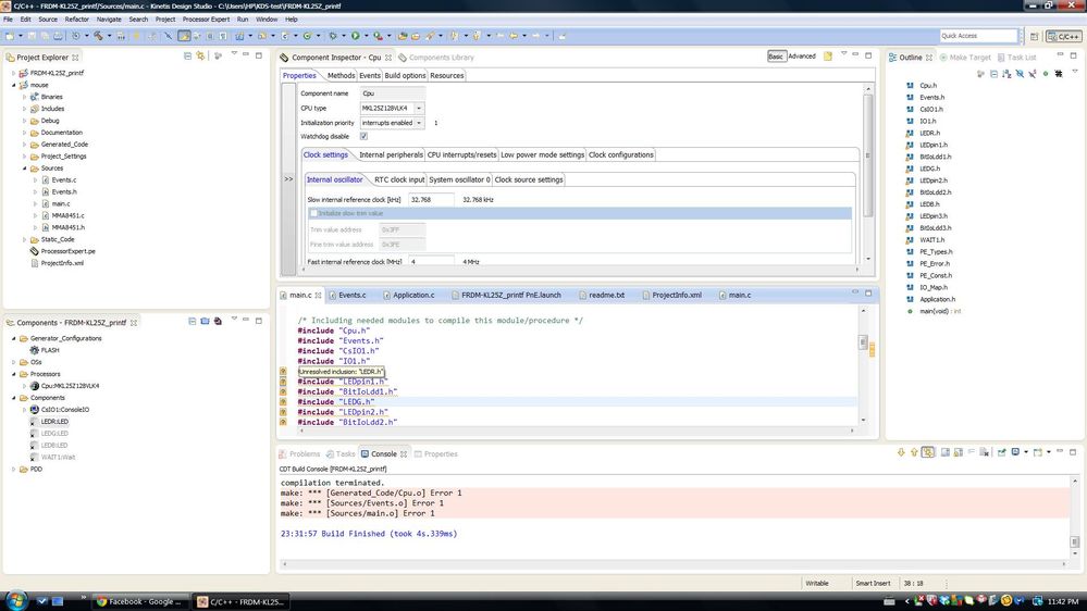

When I tried to use your example (FRDM_KL25Z-printf), there is compilation error as follow. Could you please kindly point me out where I did wrong
Thanks and appreciate your help. You have tons of projects done in Freedom boards.
Bryan
5,718 Views
BlackNight
The grayed out components in you screenshot tell me that you have not installed the needed components from GitHub.
See http://mcuoneclipse.com/2014/10/21/mcuoneclipse-releases-on-sourceforge/ how to download and install them from SourceForge.
Then generate code, and there should be no errors.

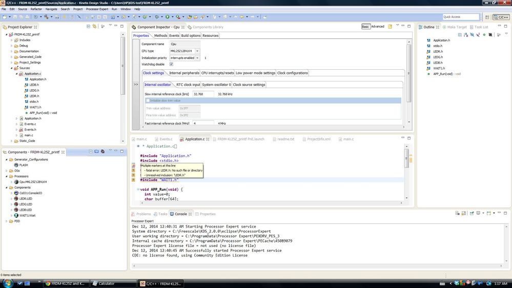

kyizawwin
Thanks Erich!
The PE components looks ok now but I still have error as below. Any path I didn't set correctly? Thanks!
Bryan
5,718 Views
BlackNight
Have you generated code already?
Erich
