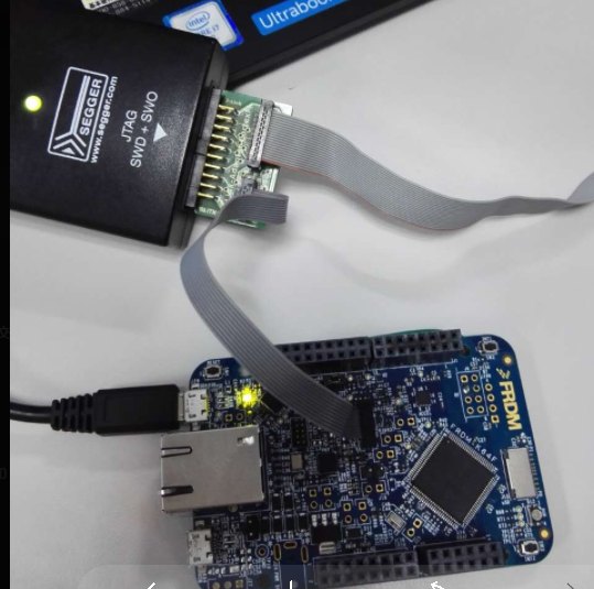

Hi Neil:
It doesn't matter , take care!
I cut J8 and J12 , according to user manual. see below picture.
I use the NXP released demo, not change anything.

danielchen
I connected with a USB stick through J22(K64USB) while testing.

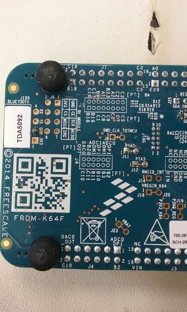

First, thank you for your help.  Unfortunately, I am not getting the same results.  Here is my setup
This is the back of my board/w cut traces.  I placed a jumper on J11 and J12, so that I can always
go back if I need to.
I am using the host_msd_fatfs_bm_frdmk64f demo from NXP, nothing changed.  I am using
RealTerm to capture the data.  RealTerm is configured as 115200, no parity, 8 data bits, 1 Stop,
and no hardware flow.
Today, I am going to see if the original dropping the binary file using the OPENSDA still works, but
if it does, then I don't know why using the P&E should be any different?
Neil
