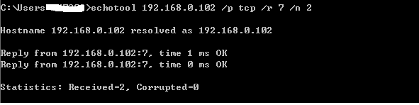

Doing my first steps with the lwip source code, I've tried running the bm source demo of the tcp echo from the ksdk. What I don't understand is that in the overview it is written:
"...The application sends back the received TCP packets from the PC, which can be used to test whether a TCP connection is available."
But at the end, when running the demo I'm receiving just this:
Reply from 192.168.0.102:7, time 0 ms OK
But in the demo I'm sending:
echotool 192.168.0.102 /p tcp /r 7 /d hello
So, how come I'm not receiving the hello word? No matter what I'm writing to the echo tool, I'm always receiving the same 5 lines. I thought I should receive the hello, or any other word I'm sending (isn't this what echo server mean?).
What am I missing here?
1,354 Views
danielchen
Hi roymessinger
You get 5 lines because this tool tried to send "hello" 5 times. 5 is not the length of "hello", it is the default value
You can change the tried time by /n
1,354 Views
roymessinger
Contributor V
Hi danielchen@fsl ,
Thanks for your help.
Still, the main idea of echo server is that it sends back the text it received. Isn't it?
I did not get anything here...
Roy
