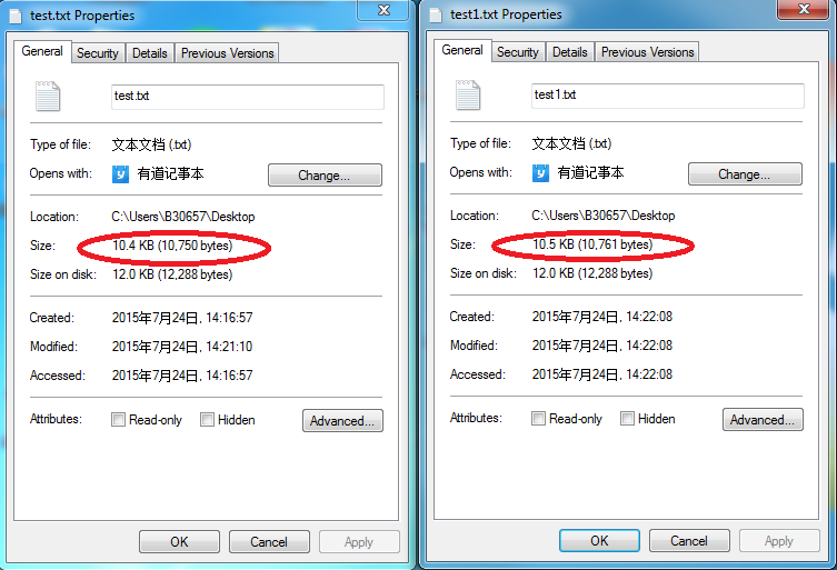

Thanks for the information! I also did the test based on FRDM-K64 with a 10k bytes text file, the example is uart_blocking, but I met another issue, the receiving bytes is more than expected,
so I guess it is not a serial port issue, but the openSDA CDC driver issue, I am going to test it without the USB CDC port, for example, based on TWR-K64F120M with TWR-SER, and will let you know when I have any result. Thanks for your patience!
