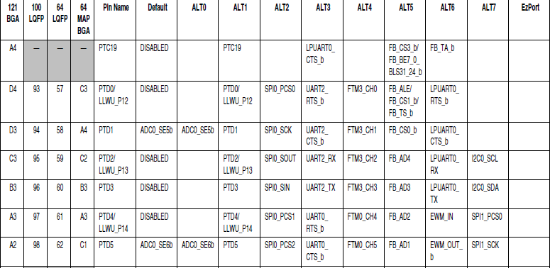

Hello all,
I am currently using KDS v3.0 and KSDK v1.3 to program the FRDM-K22F.  I am trying to output a PWM using the FTM driver into a GPIO pin on the board so that I am able to drive a the step frequency of a motor.  I took a look at the FTM driver and GPIO driver example, I am a little confused with how to set up the a GPIO pin for FTM usage.

Hi Jimmy Nguyen
You don't need look into GPIO example to implement an output of PWM using the FTM, FTM channel can be configured for edge-aligned PWM mode, and the signal will be in the pin associated. For example, the SDK 1.3 FTM example uses the FTM0_CH5 witch is in PTD5 (LED) as ATL4:
So inside the hardware_init() you can find the ftm pin configuration with:
 PORT_HAL_SetMuxMode(PORTD,5u,kPortMuxAlt4);‍‍‍
The example code set a PWM with a frequency of 24kHZ and a initial duty cycle of 0 that will be increasing and decreasing in the while(1), so you will see changes in the LED brightness:
