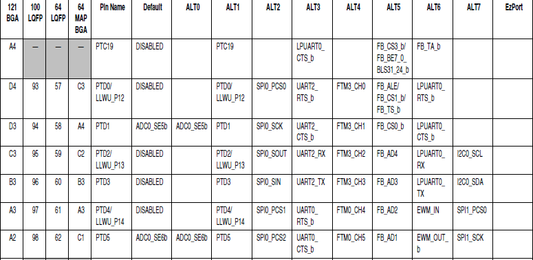

Hello all,
I am currently using KDS v3.0 and KSDK v1.3 to program the FRDM-K22F.  I am trying to output a PWM using the FTM driver into a GPIO pin on the board so that I am able to drive a the step frequency of a motor.  I took a look at the FTM driver and GPIO driver example, I am a little confused with how to set up the a GPIO pin for FTM usage.
Thankyou,
Jimmy
1,523件の閲覧回数
jorge_a_vazquez
Hi Jimmy Nguyen
You don't need look into GPIO example to implement an output of PWM using the FTM, FTM channel can be configured for edge-aligned PWM mode, and the signal will be in the pin associated. For example, the SDK 1.3 FTM example uses the FTM0_CH5 witch is in PTD5 (LED) as ATL4:
So inside the hardware_init() you can find the ftm pin configuration with:
 PORT_HAL_SetMuxMode(PORTD,5u,kPortMuxAlt4);‍‍‍
The example code set a PWM with a frequency of 24kHZ and a initial duty cycle of 0 that will be increasing and decreasing in the while(1), so you will see changes in the LED brightness:
