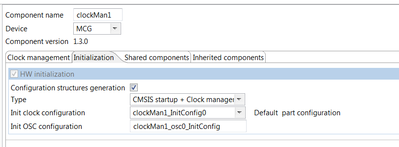

Hello, I'm using KDS v3.2.0 and SDK 1.3.0. Targeting a K22. I'm trying to go between HSRUN, RUN and VLPR modes using the fsl_clock_manager PEx component. I have also tried using the fsl_power_manager to set the power to the appropriate state before changing the clock but have not had any success.
Is there an example available, or could someone please cook one up, that shows how to transition between these states using the above components? Thanks in advance for your help!

Rande, Regarding the clockConfigNumber missing. I did find a config box labeled "Configuration structures generation".
Without that being checked nothing is generated as far as the various clock configs as best I can tell.

Thanks Mark, the config number is correct now. next problem is how to get in the BLPI mode. When I select this and build code, the generated code is using the .mcg_mode = kMcgModePEE, /*!< PEE mode */
Odd thing is this mode is not even available on the MK02 processor I'm using..

I am having the exact problem. I do not think PE fully supports the fsl_clock_manager. One problem seems to be with the clockConfigNunber it is not the same as the number of configurations set up in PE.
If anyone has been successful using PE to set up more than 1 clock configuration please advise how to,

Hello Mark,
Under the KSDK1.3,  there is a power manager demo ,
even though it without PE, while the function is the same, i think you can refer to.
KSDK_1.3.0\examples\frdmk22f\demo_apps\power_manager_hal_demo\kds
Hope it helps
