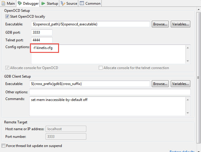

We are working on Freescale Freedom K64F Board.   IDE we are using is "Kinetis Design Studio 3.0.0" and RTOS "MQX_4_2".
In our project, program can be build successfully.
But on flash debug(GDB open OCD Debugging), an error is occurring after about 99% of its launching .
Error shown below
Error in final launch sequence
Failed to execute MI command:
-target-select remote localhost:3333
Error message from debugger back end:
localhost:3333: The system tried to join a drive to a directory on a joined drive.
How this problem could be solved?? ?? We are blocked with this and delayed in our development activity.
Hoping for a solution asap.
Rahul

make sure that you have -f kintis.cfg present:
It could be that C:\Freescale\KDS_3.0.0\openocd\bin\openocd.exe is blocked/removed by your firewall.
Another tip is to check if you have zombies running, so kill them, see  GDB Client and Server: Unlocking GDB | MCU on Eclipse
Additionally make sure you re-power (remove USB cable, then plug in again) in case OpenSDA on the FRDM board is stuck.
Additionally, I recommend to use either P&E or Segger firmware (see Segger J-Link Firmware for OpenSDAv2 | MCU on Eclipse ).
Finally, I would have this list of tips: Debugging Failure: Check List and Hints | MCU on Eclipse
I hope this helps,
Erich
