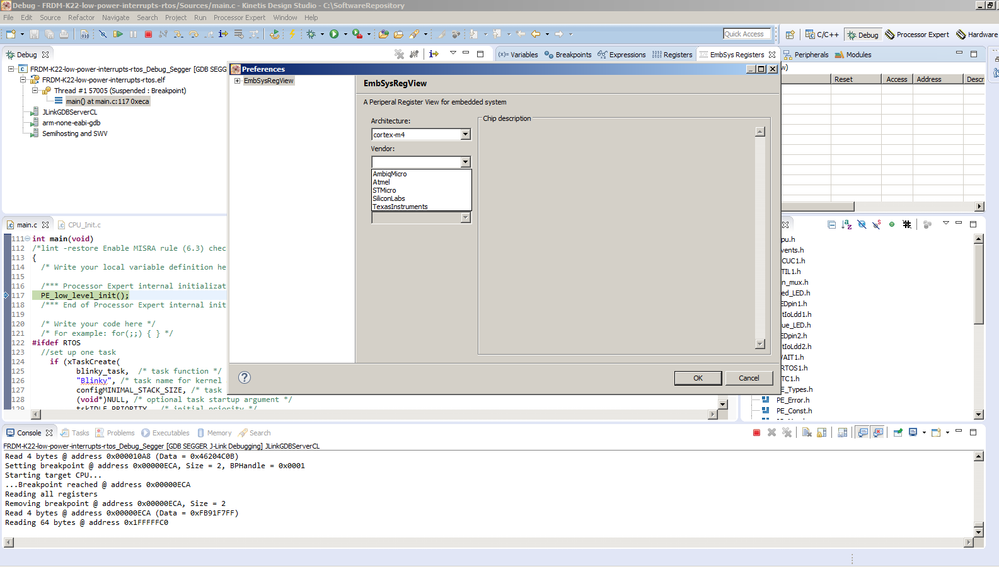

I have tried to install EmbSys Viewer on KDS 3.2 with Luna 4.4.
I followed the methods described in this forum and on mcuoneclipse.com
When I try to specify the device (K22F), NXP or Freescale is not listed in the vendor listing.
Any suggestions?

Are the NXP/Freescale SVD files present in your data files/collection for EmbSysRegView?
Depending on your EmbSysRegView, this might be different, see Adding CMSIS-SVD Files to EmbSysRegView 0.2.6.r192 and Eclipse | MCU on Eclipse

bcstewart
OK.  I see it in the ADV(CMSIS) folder.  But KDS is not recognizing it.

bcstewart
Yes, it's installed.
But if you look at the package, NXP is missing!  (note:  I temporarily
renamed the .jar to .zip)
Very strange...
--Brad

bcstewart
Working now.
Simply need to select SVD(CMSIS) under Architecture in the EmbSysReg
section and then select Freescale.  A bit different approach from the
article since I didn't create a KDS directory and copy the files.  This
is not easy if you don't have Winzip Pro.  So I simply left it as is.
