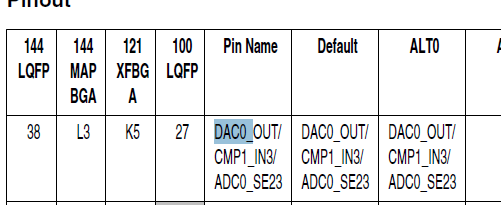

kirantujare
Thank you for helping me out. I have another doubt. I require to output 3 different waves on 3 different channels. Currently, I am checking my output on scope on Analog out (DAC0_out) pin. How do I check output for 3 channels? Which pins are used for that? Please let me know if you understood my doubt and could provide any help?
8,131 Views
Hello Kiran,
For DAC0, it only have one out put pin :
Hope it helps
