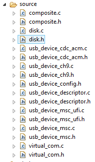

Here are the steps to copy a usb device example to a new KSDK 2.x project and build it:
1. Delete main.c from source folder of the new project
2. Copy application files from bm folder (boards\frdmk22f\usb_examples\usb_device_composite_cdc_msc_lite\bm)  to source folder. After this the source folder will be like:
3. Delete all files in board folder and copy these files them from bm folder into board folder

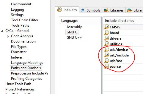

4. Copy usb driver folders(from middleware\usb_1.6.3) to a new folder usb
5. Add include directories to settings

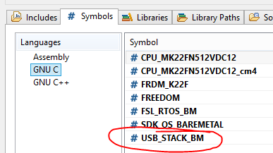

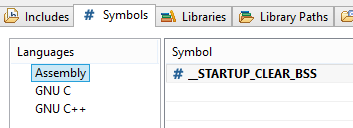

7. Add these preprocessor definitions:

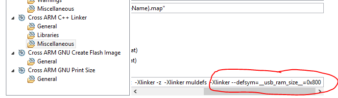

8. Add this option to linker settings:
   -Xlinker --defsym=__usb_ram_size__=0x800
Now the new project is ready for build and you have the usb example project as a standalone project.

As a related question, do you know what the '-Xlinker --defsym=__usb_ram_size=0x800' linker option does?  I was unable to find that symbol in the linker script or anywhere in the project.
3,454 Views
visakhanc
Nice to know it helped you! The linker option '-Xlinker --defsym=__usb_ram_size=0x800' was found in the project settings of that usb example. I also didn't find the use of it. I think some other usb examples may be using it.
