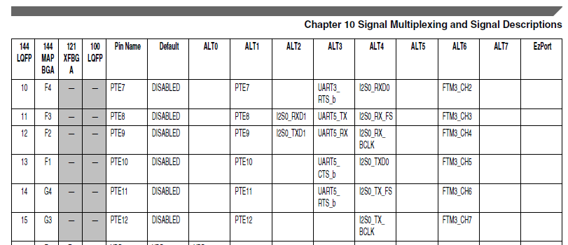

Hi, community.
Where could we find the ACTUAL meaning for the enum variable that explained as chip-specific on the SDK API manual?
For example, if I check the kPort_MuxAlt2 (which explained as chip specific), I tried to find the EXPLICIT explanation *(such as kPort_MuxAlt2: use for something) when and how I will use this value on either SDK API manual and reference manual for the chip.
Unfortunately, the Kinetic expert pin configuration tool is not compatible for the chip I am testing right now.
Is there any single document with explicit explanation to find the function on the specific chip?
Thank you for your help in advance.

Hi Kazunori,
The Kinetis MCU Reference Manual's Chapter 10 "Signals Multiplexing and Signal Descriptions" has a table to show the multiplexing on each pin and it is the "ALTn" parameter that is used to select the desired pin functionality.
Example from the K64P144M120SF5RM_Rev2.pdf:
David

Thank you, David.
That is what I am looking for.
