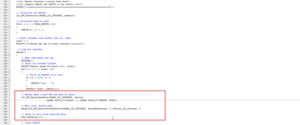

Looks like you are using I2C non-block mode in your application, so I recommend you referring to the demo in "C:\Freescale\KSDK_1.3.0\examples\frdmk64f\driver_examples\i2c\i2c_non_blocking" for details. The usage of I2C_DRV_MasterSendData() should be like the following:

Hey Kan, thanks for the reply.  The example code you listed is what I used in my code.  It just doesn't work.
If I just run past while loop waiting on the status, it doesn’t work.  I see 0x7f on the scope, or some other random data.  If I step into the API call and run down into I2C_DRV_SendAddress() and stop after the call to I2C_HAL_WriteByte() that sends out the slave address and stop before the call to I2C_DRV_MasterWait(), I see the correct slave address on the scope.  If I run past the call to I2C_DRV_MasterWait(), I see the 0x7f on the scope instead of the correct slave address.
My guess is that it has something to do with the I2C_DRV_MasterWait() but I don’t know what it could be.  I set up everything using PE for a bare metal board.
