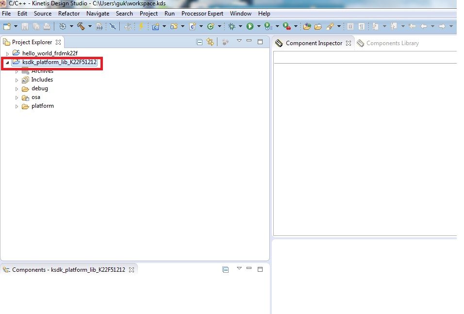

isaacavila
Hello Kent,
There is a specific ksdk_platform_lib for this MCU part, this is located at: {KSDK_1_3_PATH}/lib/ksdk_platform_lib/kds/K22FA12.
You can import this project, compile it and link your current application to this library. (Also, if you are using other libraries like USB, you should change them as well).
Once these libraries for K22FA12 are compiled, just link your application to this libraries (On project's properties > C/C++ Build > Settings > Cross ARM C Compiler and Cross ARM C Linker options).
If you also defined the preprocessor CPU_MK22FN512xxx12 definition, replace it for CPU_MK22FN1M0AVLH12 on Preprocessor section.
If there is an error when compiling your application, then, there is a difference on your application that could cuse the problem (for example, using internal clock reference like IRC48M module that is not presented on MK22FN1M0AVLH12 part). Teorically, there should be no problem when migrating for this new part but if you get an error, please let me know it.
(Note: you can see this post for a quick view on difference between these two K22 chips: Kinetis K22_120 MHz devices )
I hope this can help you.
Isaac

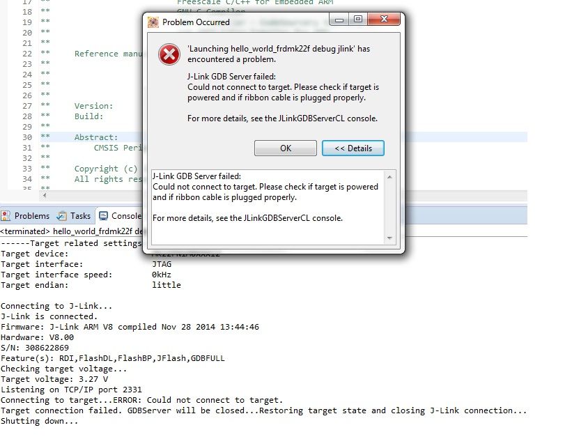

kentgu
Hi Issac,
The above your information is very helpful. So far seems that I passed the compile for MK22FN1M0AVLH12 project.
Now I meet new question, is that I can't connect the MK22FN1M0AVLH12 with J-link emulator as attached file.DebugIssue.jpg,
I am sure the bare PCB circuit is right because the board can work with MK22FN512LVH12 with J-link emulator. I am not sure it is SW issue or MCU solder issue. So may you share MK22FN1M0AVLH12 project for me if you have?  Or you can know where wrong?
Kent

isaacavila
Hello Kent,
I don't have any project for K22FA12 but i will try to create a new one although I am almost 99% sure that this is caused by a wrong connection configuration and/or hardware issues (soldering problem maybe) because it fails when communication with MCU is given.
Please check again your connection and hardware settings as well.
Isaac

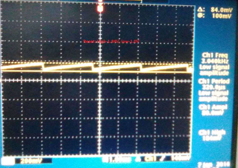

kentgu
Hi Isaac,
Yes, you are right. The project that you sent doesn't work.
Also I notice 2 strange thing:
#1, Rest signal is not high when work, it is a triangle wave as picture. I don't know why this? I used R=10k, C=1uf, RC circuit for reset.
#2, Also when connect JTAG, it report clock is 0.
Kent
6,162 Views
isaacavila
Hello Kent,
what do you mean with "project does not work", are you able to program the board and it does not do anything or even using my project you cannot program the MCU?
I will try to check your symptoms and see what the problem could be.
Isaac
6,162 Views
kentgu
HI Issac,
Sorry for your above describe.
#1, Your project does work
#2, The board can work now after I re-solder another MUC.
Thanks l lot for your help in these days. Your help is appreciated!
Kent
