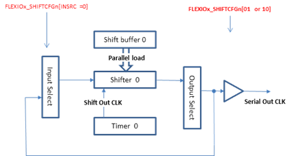

Is it possible to implement barrel shifter using FLEXIO with following configuration?
 FLEXIOx_SHIFTCFGn[INSRC =0]
and
FLEXIOx_SHIFTCFGn[01 or 10]

Hi Rong
In my application I want to use FlexIO as Barrel shifter (not as communication device).
The function is "parallel in serial out".
  1. Parallel load “Shift Buffer” by core
  2. Shift buffer to Shift register
  3. Shift Out by Timer to selected IO (Port)
    1. Shift out serially using Timer
    2.  At the same time the output is also returned back to the shifter
  4. Number of Shit-Out clocks can be any integer greater than 100 < N< 10000.
  5. Stop by Core on external event (Interrupt).
The question is this can be implemented using FlexIO?
From reading K43 Reference Manual I think that it is possible and I want to verify this.
My assumption is that this configuration will do this.
FLEXIOx_SHIFTCFGn[INSRC =0] and FLEXIOx_SHIFTCFGn[01 or 10]
Please see attached block diagram.

Hi, Shaul,
I think the solution is feasible.
