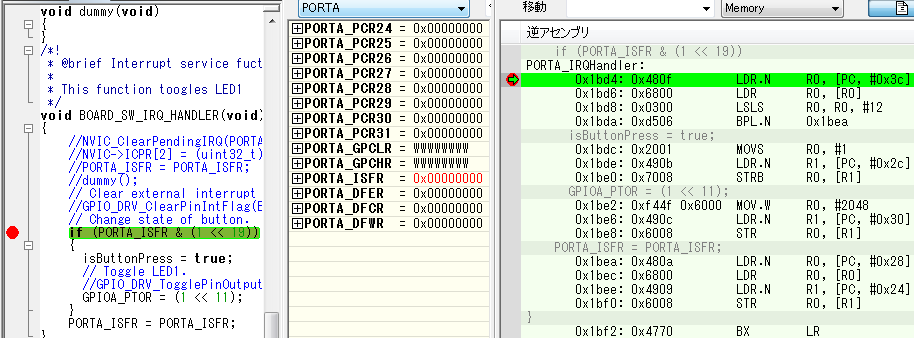

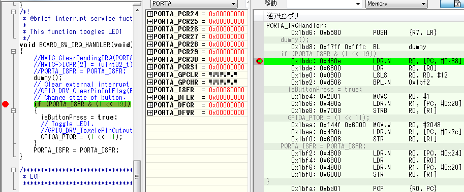

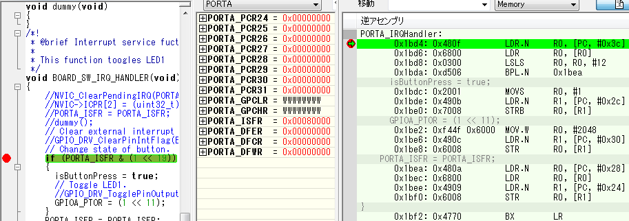

isaotakashima
Dear Rastislav Pavlanin,
Thank you for your reply.
I'm using IAR EWARM Ver 7.60.1. If you use another tool, you will not reproduce this issue.
I have the additional information, this issue depends on return instruction to main() routine.
If I don't call any function in ISR, return instruction is "BX LR".
The following picture is ISR after press SW1, then ISFR = 0x00080000.
The following picture is ISR after click RUN icon, unfortunately ISFR = 0x00000000.
If I call dummy() function in ISR, return instruction is "POP  {R0, PC}.
Could you please explain reason why cause this issue if return instruction is "BX   LR".
Takashima
