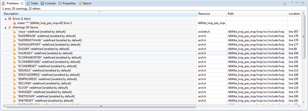

Kan, I'm not sure how to resolve this problem.  Perhaps my sample program has more SDK files included than it should?  The problem is that mqx_stdlib/source/include/std_prv.h #includes nio.h.  nio.h #includes errno.h.  But lwIP #includes arch.h, which has the same error codes, but the values are different.  Should I be removing some of the files that the wizard included if I'm using lwip?  Or do you have access to, or can you create an example that uses lwIP with PEx?

Hi Kan, I'll take a look.  I do get those same warnings.  I'm glad you brought this up, because I looked into it again, and apparently the values are different in the conflicting files.  When I looked into this over the weekend, I could have sworn the conflict was coming from two different files with the same contents, so I didn't pursue a fix then.
The problem here is that arch.h used by lwIP has contents that conflict with errno.h in /rtos/mqx/mqx/source/nio.  I'll try playing with the include directories to get around this.

and I am not expertise for LwIp, so I am not familiar how to create an LwIp application, but in my opinion , you may start from BM application, that is without any RTOS, you know , most of the warnings are from the conflicts between LwIp lib and MQX lib, so how about bring up a BM application at first? maybe it would make things easier.

Kan, it looks like you're getting bitten by the 8192 maximum character command line problem in Windows.  The file is called fsl_mpu_common.o, and when characters magically get removed from filenames, that's a pretty good indication that it's the 8192 char problem.
Please see Erich Styger's post here on how to fix it the easy way.
