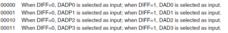

But how to Init and using the temp sensor, also how to init and using the DADP & DADM as normal ADC pin
Thanks in advance!

I have read the an3031, and refers to many details about the temp sensor, but i can not figure out how to connect the temper sensor with the single-ended or differential mode ADC channel. if temper sensor using differential mode channel, then how to differ DADP and DADM, also how to figure out the channel, just like following
   adc16ChannelConfigStruct.channelNumber = DEMO_ADC16_USER_CHANNEL;
   #define DEMO_ADC16_USER_CHANNEL 8U
Thanks in advance!
-Jack

The temperature sensor is "a P-N transistor junction with temperature dependent properties acting as an
embedded temperature sensor", the temperature sensor is embeded in the processor internally, you do not need select pin assignment, you just need select channel 26, the DIFF bit can be either  set or cleared, it is okay.
Hope it can help you.
Xiangjun Rong
