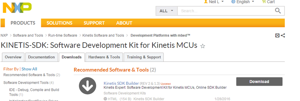

nanren888
New to this. Someone tell me the missing link. please
SDK builder -ok
Choose board, choose design studio - choose windows
Create SDK
download sdk
Kinetis Design Studio V3.0.0- User's
Guide ==>
4.1 Installing Kinetis SDK
2. Double-click to launch the executable.
.. there is no executable.

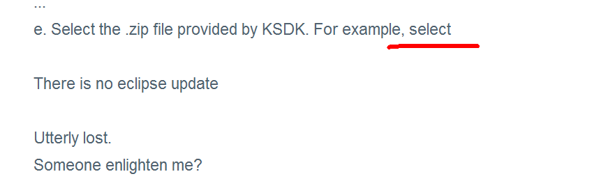

4.2 Installing Kinetis SDK into KDS
2. The Kinetis SDK installation directory contains an Eclipse update.
e. Select the .zip file provided by KSDK. For example, select
There is no eclipse update
Utterly lost.
Someone enlighten me?

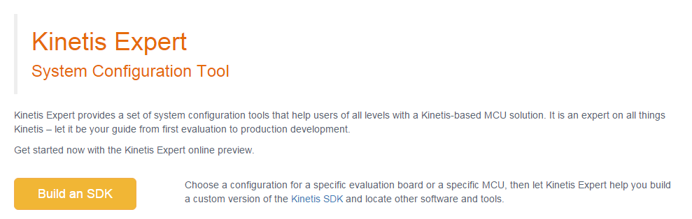

Google nxp kinetis sdk
Software Development Kit for Kinetis MCUs|NXP
Looks well written & very promising.

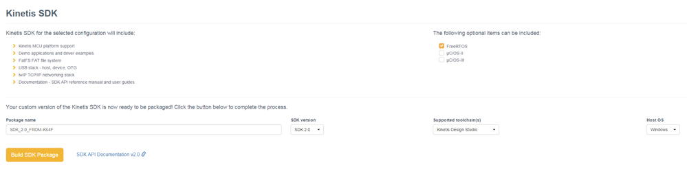

SDK builder -ok
Create SDK
download sdk

e. Select the .zip file provided by KSDK. For example, select <DownloadDir>
KSDK_1.2.0\tools\eclipse_update\KSDK_1.2.0_Eclipse_Update.zip.
This file does not exist.
OK, which version?
No idea - I took the one offered. The one generated. The latest, I guess.
The instructions do not match the reality.
I'm very happy to believe that I have mistaken something & am doing the wrong thing.
In this lives really useful feedback on  the system as seen by newcomers.
I am happy to accept that I am asking the wrong question, or aiming at the wrong thing, but I'm new & doing as the manual tells me, using the manual I found easiest. They all seem so well written, but just don't match my, flawed, reality.
Which leaves me ....
utterly lost.

Hello Neil,
1) I know your question now .
First i want to tell you that , there is KSDK1.x versions(for example KSDK1.0 KSDK 1.2 KSDK 1.3) and KSDK2.x version ,
the method to install the KSDK1.x is different from KSDK2.x .
About download and install the KSDK2.x , please refer to Using Kinetis Design Studio v3.x with Kinetis SDK v2.0
About the KSDK1.x, you can refer to the "Kinetis Design Studio V3.0.0- User'sGuide"  .
