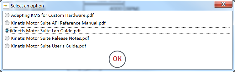

The best way to run a example out of KMS is following "Kinetis Motor Suite Lab Guide.pdf"
In KMS, open VIEW menu and clock on Documents. Select KMS Lab Guide (as in picture below) and click ok.
Follow Labs, specially 3.1.7 and 3.1.8 section.

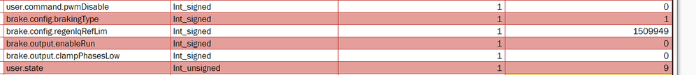

Below is an example of Variables you can change in Watch window to test what do you want:
user.state and brake.config.brakingType are the ones you need to change from RUN to Brake States and brake.config, is the one you can select the way brake will act.
