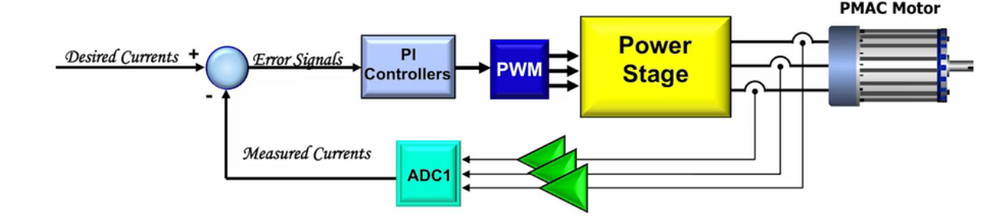

I need to modify the freedom project to work with my custom design, the voltage and current range is easy enough to change but I have two in phase current sense rather than 3 low side. What is the correct way to set it up for this configuration.
The documentation says to open the project in KDS and replace the 3 shunt file with the two shunt one. Do I just enable feedback_2ph.c save the project and launch KMS to flash it? Secondly how do I specify which phases the sensors are on? I have sensors on phase a & c but feedback_2ph looks like it's configured for Ia and Ib, the documentation doesn't say how to modify it. Since they are in phase is there anyway to take advantage of being able to measure current at all times?

Since there are only two phase currents measured they are referred to as Phase A and Phase B.  So to properly assign the channels use Table 7 in the Adapting KMS for customer hardware document to change the ADC assignments for the ADC channel you connected to and are calling Phase B.  This would be the channel sampled during Sample A on ADC1.  In adc_sys.c you need to change the #define for that sample and channel.
* @def ADC1_SAMPLEA_CHANNEL
* @brief Channel to sample for motor control on ADC 1 Sample A
* Phase B Current
From:
#define ADC1_SAMPLEA_CHANNEL (kAdc16Chn0)
To:
#define ADC1_SAMPLEA_CHANNEL (kAdc16Chn3)
Then when feedback_2ph.c is called it will pick up the phase current you have connected.

Back to the original question.  I was corrected by the KMS system architect that the change from using current sense C in the place of current sense B in the feedback_2ph.c operation will have issuses with angle calculation. Here is what he told me:
" I'm concerned about him simply re-mapping the channels since they go into the 3 phase to 2 phase transform.  That could cause issues with the angle estimation.
He would be better served by keeping the A & C samples mapped where they should be and modifying the code so that it does the reconstruction based on A & C samples.  In the feedback_3ph.c file there is an example of all 3 different types of reconstruction in the following switch statement:
if (svpwmState != SVPWM_NORM)
            switch(svpwmSector)
All he would need to do it look for which case is calculating the missing sample, in this case B which is:
case SVPWM_SECT2 :
case SVPWM_SECT3 :
He can then copy that code into feedback_2ph.c to replace the code that reconstructs the C sample."

The file feedback_2ph.c was written assuming you have A & B phase sense.  So there are a lot of places where it refers to having phase B current that are not applicable in your application.  You will need to modify the other places in the file where it is using the phase B measurement and replace it with your phase C measurement.  The first one that comes to mind is the function FEEDBACK_runOffsetCalibration.

The optimal current sensing solution is going to be application dependent.  The software is flexible enough to handle almost any type of current sensing.  You will need to choose the best for your application goals.  Shunt-based measurement is inexpensive but since it can only measure when the low side resistor is enabled you can't run in the overmodulation region (and therefore at maximum possible torque) with only 2 sensors.  Hall-based measurement is more expensive but allows for overmodulation when only using 2 sensors.
