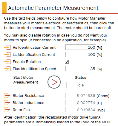

KMS GUI detects parameters as below:

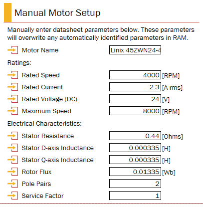

Lowering identification currents increase the stator resistance up to 10 ohms.. So, I went over to Advanced Tuning, Manual Motor Setup and copied the values I saw from online training videos which use the same motor:

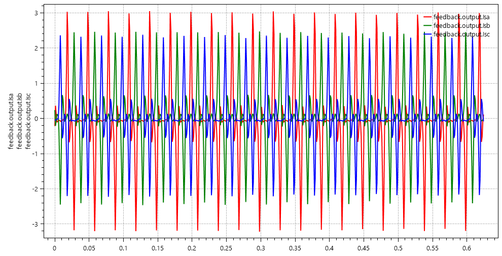

Do you think LMV324 as current sense amplifier could be the problem?

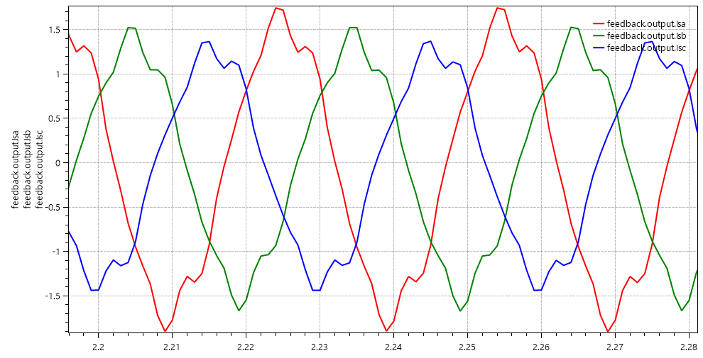

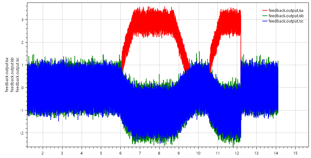

How do I verify that my phase currents are being read correct? Below, I put phase currents' graph when the motor is turning at 1000 RPM in open-loop mode.
14,658 Views
linestream-adam
Senior Contributor I
It is possible that your opamps are the problem, they are quite a bit slower than the FAN4852.

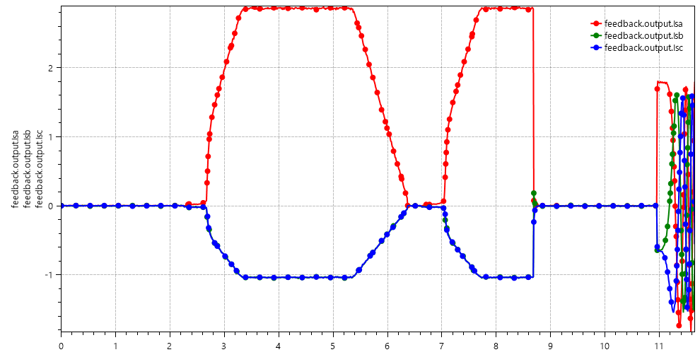

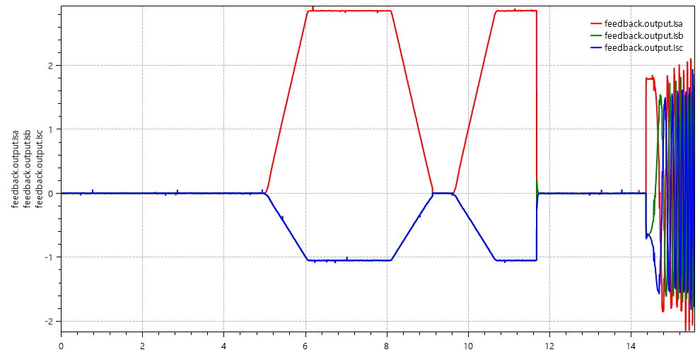

I've found it is easier to make sure that the phase currents are reading correctly when doing the resistance identification as this will inject a known amount of current into the motor (80% * sqrt(2) * Rated Current) which should be along the A phase, while B & C phase should be half the value and negative.
The captures you posted have the current not balanced, but I would be interested to see what it looks like during resistance identification.

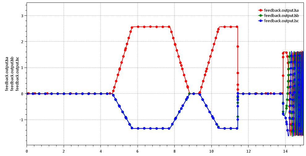

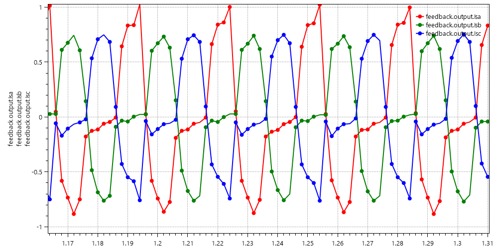

I have changed my opamp to MAX4354ESD+ as I suspected that could be a problem. However everything remained the same.
Here is the graph you have asked about, with the new opamp. Rated current of my motor LINIX 45ZWN24-40 seems to be 2.3A.
Here are phase currents with the new opamp, running in open-loop at 1000 RPM:

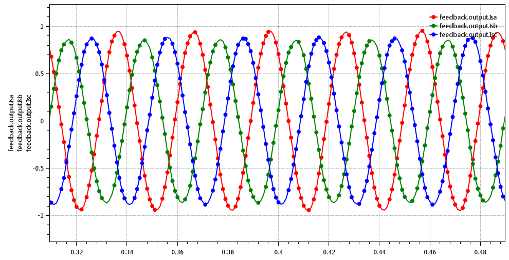

No worries.  I had hoped I solved the issue :smileyhappy:
I'm concerned about the level of noise on the current feedback signal.  If I compare your graph with the one I get for the TWR evaluation kit you can see the huge difference.
Even running open loop the eval hardware is much cleaner.
The algorithms used in KMS can tolerate some amount of noise, but I think your design has too much.  I would suggest looking into ways to reduce the noise on the current sense lines.

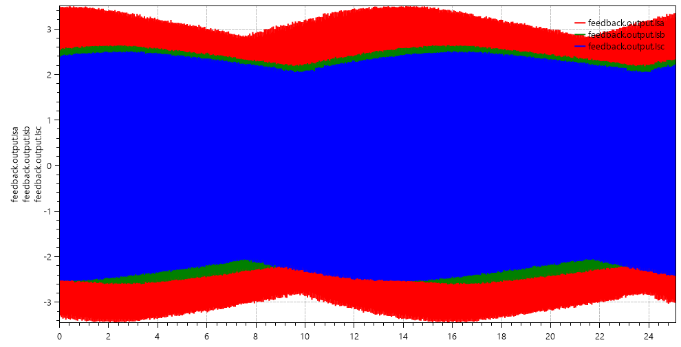

abdullahkahrama
Hello Adam,

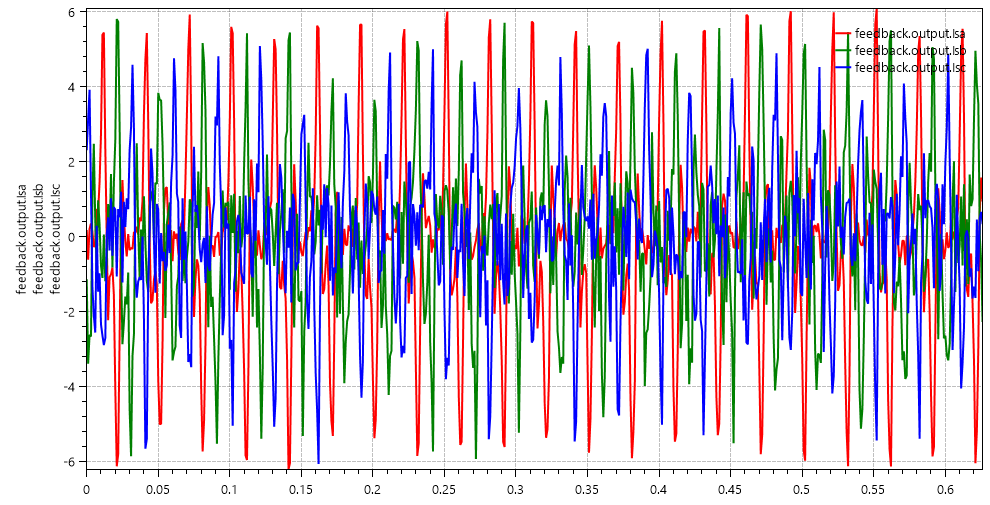

I've changed my OP-AMP to TLV274 and things seem to be much better now. There was a discussion on this site about my design.
Closed loop control is noticeably better now but still not reliable, even with the hand-corrected parameters.
Here are my new graphs, they seem much noise-free. The parameter measurement is still wrong, especially the resistance.
Open loop at 1000 RPM:
14,658 Views

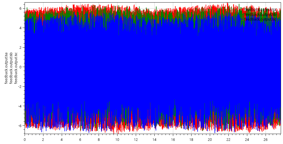

Oh, I've found the problem. It was the bootstrap capacitors for gate driver IC FAN7388. They were not enough, so I made them 2.2 uF and problem solved. The parameters are measured correctly now.
However, my graphs are not as clean as yours

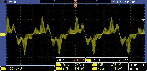

Here is the pin 18 of the MKV31F512VLL12P measuring phase C current. 14kHz noise filtered, scope and probe is 200 MHz, ground lead is smaller than 1 cm:

linestream-adam
I'm glad it is now measuring the correct parameters.
I would suspect that the TWR hardware signals would be cleaner than the FRDM (based) since it uses a more robust amplifier design.  Your signals are probably clean enough, and as you get into larger currents your signal to noise will improve.
