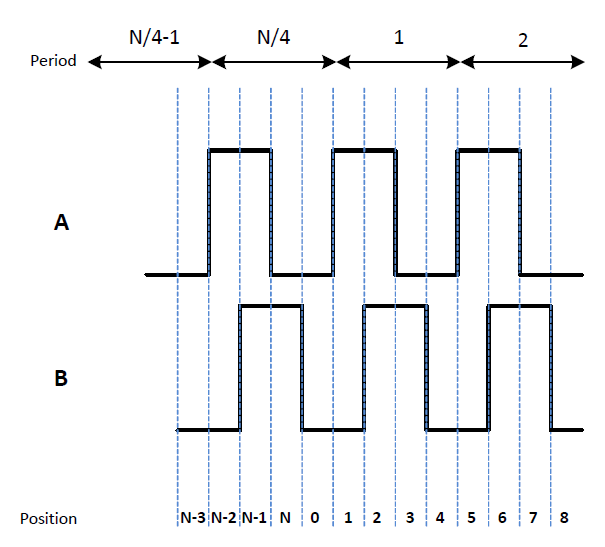

Why "512", because I read:
PPR, P/R, sometimes notated as C/T  =  Pulses per revolution
LPR, L/R  = Lines per revolution (same as PPR)
CPR  = Counts per revolution. Usually means encoder resolution after 4X decoding. However, some manufacturers (such as Avago and USdigital) specify PPR value as CPR.
This is an Datasheet Example Quadrature Output for 8 Positions
If I configure the output for 2048 positions, the Encoder Lines may be:
                                                                            counts/rev              2048
USER_MOTOR_ENCODER_LINES = -------------------  = -------------- = 512 Lines
                                                                    x4 Decoding            4
It's this OK ??

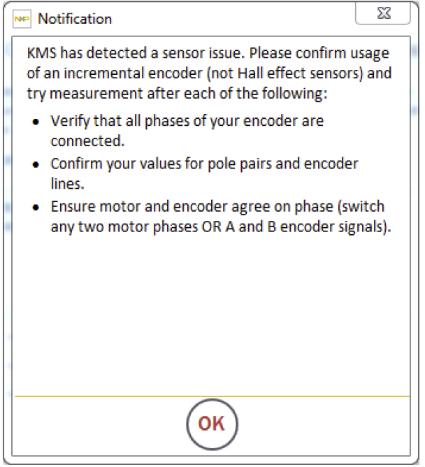

Allways appears an error:
I try change two phases of motor, and change two signals of encoder by software in qei_sys.c
#define HW_CHAN0             (0U)       /* FTM Channel Assignment for PHA */
#define HW_CHAN1             (1U)       /* FTM Channel Assignment for PHB */
// #define HW_CHAN0             (1U)       /* FTM Channel Assignment for PHA */
// #define HW_CHAN1             (0U)       /* FTM Channel Assignment for PHB */
If a read the QEI using   "uint16_t QEIS_readPositionCounter(void)" function, the signal is read correctly.
The motor turn one or two seconds and appers the error.
Sometimes, the motor turn in the one side, and next try to turn in another side.
But I can't get to KMS accept the parameters.
What am I doing wrong?

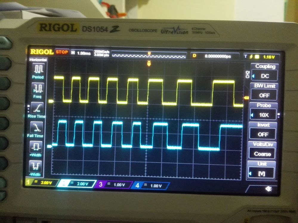

sergigomis
Hi Adam.
I use the magnetic encoder AS5601, but I will change to AS5047D in the next prototypes.
The ABI signals are OK. And yes, I tried to use 2048 instead of 512, but nothing. I tried all possible combinations.
With 512, is the only configuration that motor turn a few seconds before appear the error window.
This is the ABI signal in the input of MKV31.

linestream-adam
Senior Contributor I
Sergi,
Those signals look pretty good.
