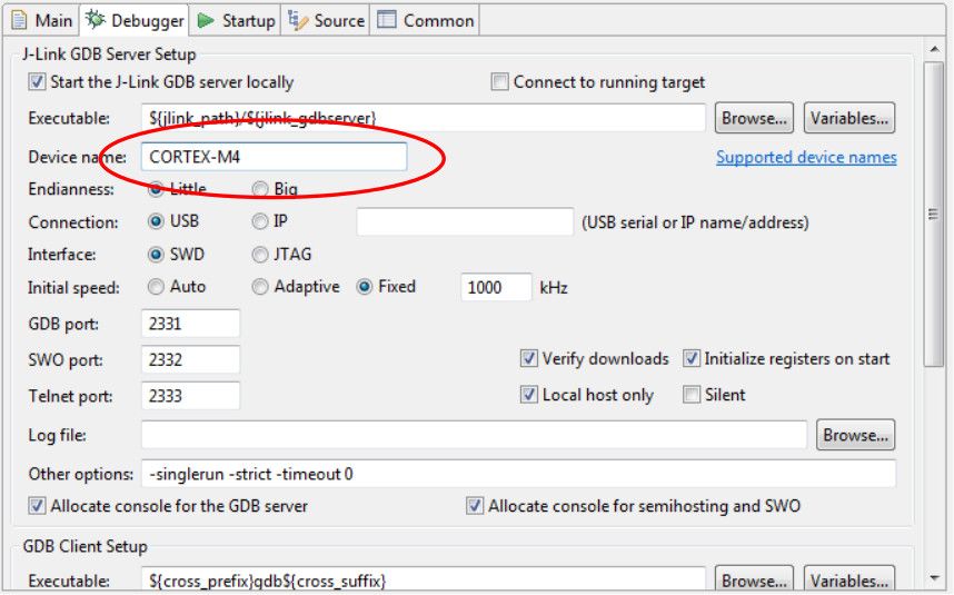

Finally I found the problem.
I have never worked with j-link debugger.  By default, the debugger, fill the "Device Name"  with "CORTEX-M4".
To work properly, I must write:  "MKV31F512xxx12".
Finally I succees program my own board and WORKS !!!!!.

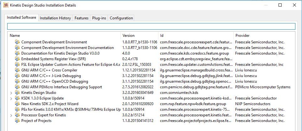

2) to grab the latest P&E Eclipse updates. Here is a snap-shot of my KDS3.2 Help --> installation details information:
I understand that P&E will be updating their eclipse plug ins very soon.  This might also include a firmware update for the multilink and the developement hardware.  Check this out by going to www.pemicro.com/opensda/
I've just tested this with KDS3.2 with the installation profile above and a P&E Multilink FX Rev A with good result. I was able to download the reference project to my hardware and run and debug from the multilink.

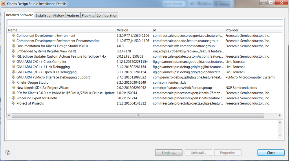

Hi Philip.
Here is my KDS instaled components.
