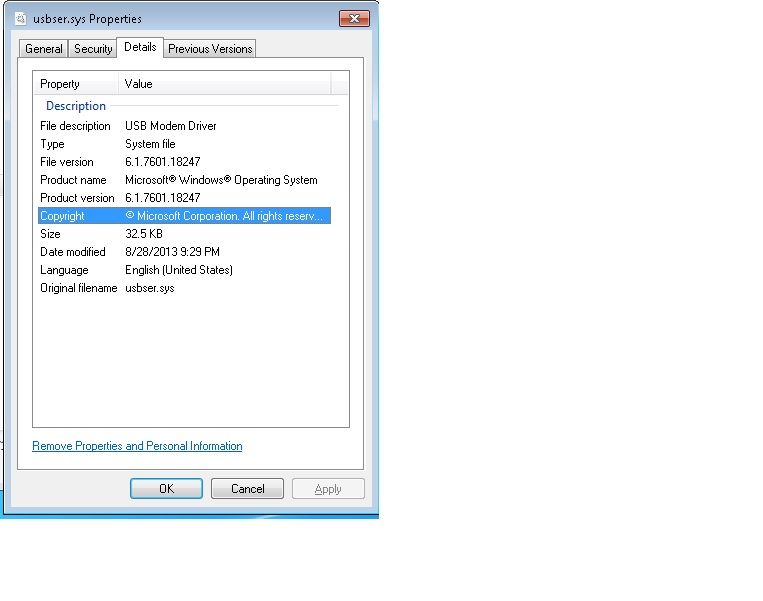

Keith4DSmith
Contributor V
Windows 7 Enterprise Service Pack 1
