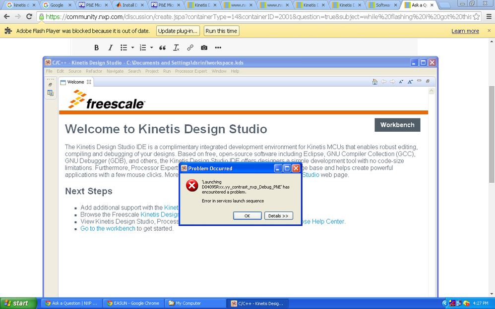

while flashing i got this error "{Error in services launch sequence}" plz give sollution to solve this

Hi gobi s
This error occurs when you are no selecting you interface correctly, Could you explain you case more:
Debug configuration?
What example code are you using?
MCU that you are using?
Jorge Alcala

gobis
Hi Jorge,
Thanks for your reply...sorry for late reply,,
Details below about your questions..
GDB PEMicro Interface debugging
Our freescale controller is MKE02Z64 VQH4(MODEL: FDRM-KE02740M)..into
controller MKE02Z16VLC4 I want to flash.
Actually i am using the code which already developed by some one...no
error in that because who developed that code they had flashed &
checked..in my end it is not happening...i need your support to finish
that flashing..
S.Gobi

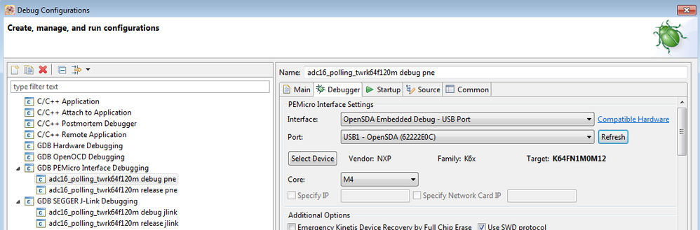

jorge_a_vazquez
Hi gobi s
Could you share a screenshot of your debug configuration? in P&E micro it should appear selected an Interface and a PORT in the debug configuration window as follow in the next image:
If you are not able to select both of them, please check that your device manager can identify your debug interface and let me know what you get.
Hope this helps,
Best Regards
Jorge Alcala

gobis
Hi jorge,
In device manager it is OpenSDA- CDC Serial port(com7) comes
underports(com&lpt).
thank you

BlackNight
a common reason for that "error in services launch sequence" message is that there is a dangling GDB server. See https://mcuoneclipse.com/2015/05/18/gdb-client-and-server-unlocking-gdb/ . Can you check that the P&E GDB server is not still running (if so, kill it in the task manager)?
I hope this helps,
Erich
5,963 Views
gobis
thanks eric..for your support
I found problem, and I had flashed...
problem is firmware of freescale board is not updated..

gobis
Hi jorge,
plz find the attachment of screenshot of my debug configuration..as you said
port i cant able to select but in device manager, i checked driver for
freescale got installed . Eventhough i cant select port..
Thank you
